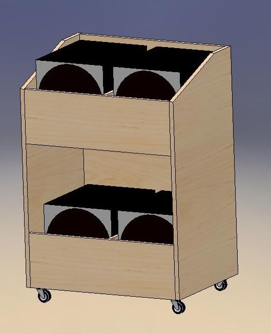

    Another member built one of these and I needed something to occupy my mind a bit. So I mocked one up in Solidworks to see what I could come up with. All in all it is a simple and nice looking bin.
    It will hold between 500 and 600 records, currently modeled with 125 per section. (assuming 1/8" thick record sleeve.) so 500 is a conservative estimate. Top of record in the top bin will be @ 39" above the floor, a nice easy browsing height.
    I have not built this yet, it is winter and I'm not sure I'd have the room. It was mainly done to see what I could get out of a sheet of plywood. Were I to build it I'd glue every seam and use nails / or screw to assemble. A solid glued seam will be strong as an ox once it drys. Below is Chimpkin's original post that inspired me to think on this, followed by my images and the cut drawing. If anyone builds from these plans, post a pic, I'd love to see it done in reality. Thanks to Chimpkin for the inspiration.

    V2 Has Casters (easily added to V1) rated at 90 lbs per corner for a total of 360 lb capacity. 600 180g records weigh 240 lbs.
    Caster: http://www.mcmaster.com/#catalog/116/1329/=agjps5
    V2 also has a simpler cut list which results in deeper bins. I personally prefer the look of the shallower bin so I've posted both cut sheets.

    Good call on the supports. You could easily cut a couple 1-1/2 thick strips and glue / screw those under the shelf to give it plenty of added support.

    Nice Max. I updated the cut list drawing to match your layout. Not only does it reduce the cuts needed, it allows for 4 cuts to be made at your local home depot so that you can put the parts in the back seat of a typical car. Nice. I didn't adjust any of the heights, couldn't quite see where you added an inch and I have ideas for the scrap anyway :)

    Quick question would one be able to put casters on these? Wife likes them a lot just wondering in case she needs to move them from time to time. I want to put two to three in the living room and one in basement work area.
