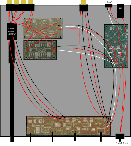

Okay, here is what I've got. This is how I am envisioning a preamp with ESP boards:
I'm not sure I entirely understand the grounding situation on this rig. But I'm confident that Rod's instructions will illuminate things quite well.
A couple design notes: Everything should be very close to scale. I took the measurements from Rod's website and built those in. The case size was chosen to match the footprint of my amp. I flipped Rod's suggested layout so the power wires didn't cross any of the signal wires until after it went through the preamp.
I decided to forgo the headphone amp in this build. It was just proving to be too difficult to incorporate. The big thing was that I don't think I could effectively get any volume control without adding another pot. So I may end up just making a different box for it.
Anyway, the lines are open to your suggestions. Please let me know if you see anything that could use a change. Thanks for your help!
Are you going to have a transformer in a separate case or is that just not depicted?
That headphone deal sounds like a major complication to this build (if using one of Rod's better offerings). I'm sure someone here has a more elegant way to get it done, I have no experience with headphone amps.
You're layout looks fine and workable.

if you get PCB-mounted pots for the front board, then you could conceivably push that board back toward the rear as far as possible and get extension shafts for each pot. it would dramatically reduce the amount of hookup wire you'd need, at least by a factor of 2.

The P05 has facility for an AC muting circuit but this means you need a transformer with dual secondaies. Not a big deal, it's probably easier to source than a stand-alone, single rail 16v. AC supply. Also, you can size the transformer to your needs. Additionally, it could be mounted in the same case. You could mount the transformer and PS board toward the back and enclose them with a shield. The RIAA equalizer and phono board would be shifted towards the front of the case.
The output wiring would shift towards the side, swapped for a central IEC fused Power inlet module. I would have the input wiring on the opposite side, as depicted, but forgo the extension shaft and place the rotary switch on the front. My thinking on the last is that the price of the shaft extension and compatible rotary switch would be better spent on a better rotary switch and, with proper cabling, the switch location for input wire doesn't make any difference.

I believe the P-05 is one of the earlier revisions either P-05 or P-05A. Looks like it is a P-05A.
PM me if you need a transformer....I have a low profile 15-0-15vac 30VA it measures-(L) 68mm X (W) 56mm X (H) 35mm AVEL-LINDBERG potted toroidal. Avel P/N --OB30/15

Rod seems pretty convinced that the switch needs to be back as far as possible. I've poked around in enough receivers to know this is rarely done in practice. Any strong feelings about this out there?

I use Rods po5, p97 and P113 boards all in the same metal box and it works fine.
The p97 pre amp with tone controls has no noise or coloration at all, very nice.
The p113 headphone amp is also very good. I prefer a small 10 ohm resistor at the output instead of the 120 ohm he recommends. I also lowered the gain to something like 2 down from 27 IIRC. Less noise and the dynamics are still there.
Lastly the LM317 and 337 regulators on p05 board need to be loaded to at least 100 milliamps apiece for best noise and impedance. I had to add low value resistors in the pre amp to get the loading correct. A center tapped transformer works best here. I put my toroid in another box for best hum and noise rejection.

Do you run the P113 with signal from the P97? I wasn't sure if it would be appropriate to run the headphone amp with the line level signal. If I can control the volume of the headphone amp with the pre, then I may put the P113 back into the design.
