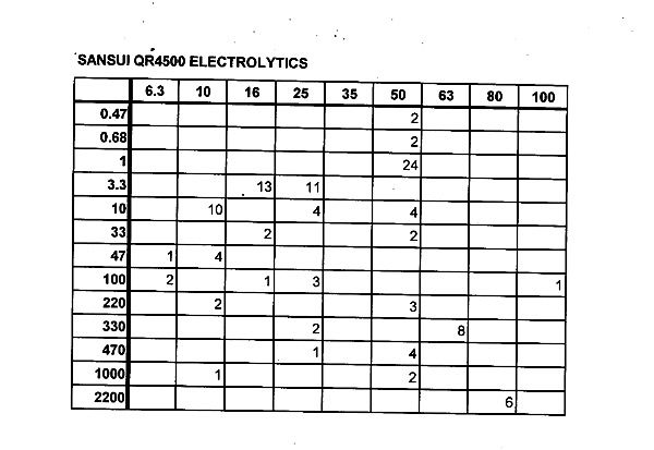

Hello, I've got three of these QR 4500's sitting on the shelf waiting for testing and recapping. Do you have a cap list you used to order your parts? It would be much appreciated. I know it has been a long time since you worked on this but it would really be a time saver to have a list. I also have a QRX 9001 and a 9090 that I'm not touching till I finish these three. .

Not here. I use Vishay caps almost exclusively as they are superb quality. And cool blue ;-). My stock is large so I don't need to BoM every time I am working on something.
When I don't use Vishay I generally take Panasonic caps. I have never encountered a situation where Vishay or Panasonic did not fit the bill.
Don't get hung up on the 'audio capacitor' discussion; any high grade capacitor will outdo 40 year old caps.
For small values in the audio signal path (up to 4.7uF) I use Wima film capacitors.
Some ceramics I change for c0g mlcc caps, this depends on their location, function and state.
Sometimes I change ceramics into mlcc just because they are so dirty and stinky even after thorough cleaning
The eye also wants some candy.
For the QR 4500 I used Elna audio grade filter caps; these work fine but they are expensive.
If I didn't have this batch already I would have used Vishay.
Just make sure that you order the caps with the correct diameter!
Height is personal preference; I like to use minimum half of the height of the original.
But again: more height in these filter caps means more money.
No guarantee the list is complete as this was a while back, and some of my notes get lost as I get into these things, but this should get you going. Went all Elna Silmic here when possible, but had to go with some Nicholson and Panasonic audio grades to fill in what wasn't available. I was also able to find the big caps on fleabay for a later project - maybe counterfeit, but they test good.

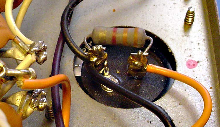

** All the big caps I've seen are twist in. What I've done in the past is clip the spades on the old caps close to the cap, then just solder those to the twist terminals. Works great, but make sure you get the polarity right on each. Lot easier than moving all the doodads to the new terminals, and no problems with the wire length as there's not a lot of slack to work with.

The list is a good start. I remember the 4500's had some noise and the controls were dirty. I was working then so I just stacked them on the shelf. I've got over 300 caps in stock. Most are Panasonic PC and some Nichicon 1uF. I'm looking at the Wima, Vishay and Kemet film caps cause it is cheaper to buy by the hundreds. I've started a spread sheet for 14 different receiver's with caps and board locations. Mostly Marantz first and Sansui next with Pioneer and Yamaha later. I double check the manual list and finalize after I see what is installed in the unit.. I've got 3 sets of receivers to help me learn one unit really good. I'll do a rebuild 3 times. I'll update the cap list for the QR 4500 and send it back to AK.
That's a good idea on cutting the lug instead of unsoldering everything. I like to take pictures before I start any work.
