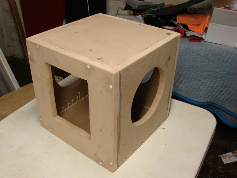

The box itself is 13" square, pretty small. Here it is in clamps, glued and screwed. I used corner clamps on top, and one of the end caps on the bottom to keep it square to the world.
Once I added the end caps, I cut the openings with a jig saw according to the template provided. I wasn't too worried about accuracy but I did have to hog out the plate amp opening a bit to get a proper fit.

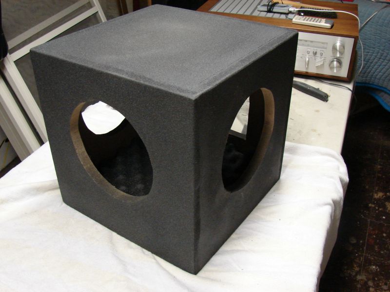

I painted it using a textured Rustoleum rattle can thing. Looking back I should have used something else, the texture grabs dust and lint like crazy. You can see the sawdust remnants in the finished pics.

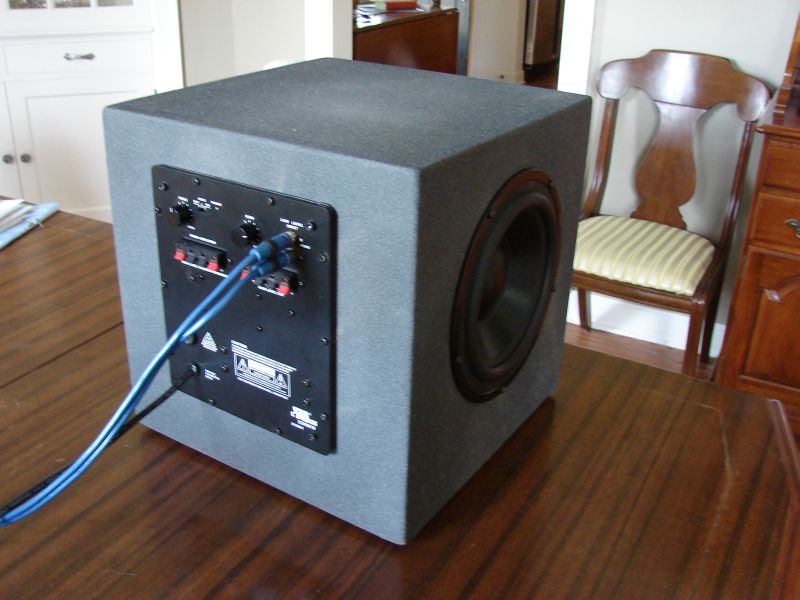

All that was left was to screw in the plate amp, passives, and woofer. ShawnA (designer of the sub) provided some email assistance in adding mass to the PRs. Just add 8 washers to an M5 screw and locktite them in.
I've been listening to it for about 45 minutes now, using the pre-amp out of my Bel Canto to feed the plate amp. No, it doesn't thump, but I now have the right amount of bottom to my tunes!
Total time, about 3 hours. Total cost, about $150.

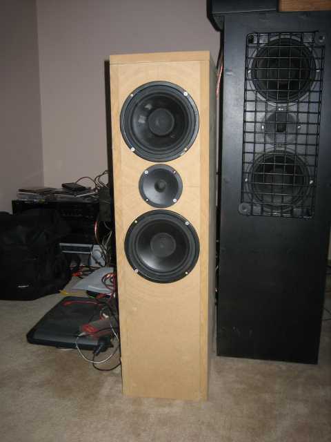

For those that missed that little bit of an obscure thread, he's talking about the grills on my black monstrosities that you can see here. I was wandering through Walmart looking for something cheap and easy that I could stick on the front of the speakers to keep the kids balls, swords, airplanes, etc. from massacring the drivers. The work pretty well but they can still poke through to the dustcaps if they try. One of these days I'll finish those...or maybe not. The nekkid ones in the pic now have real grilles.
