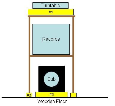

So I've read a lot on these forums and others about proper turntable isolation/decoupling/damping/etc. I've got a setup that could use three unique solutions/applications, and am not sure how to best apply what I've read.
I have a wooden shelf/component cabinet, on top of which my turntable sits. My records sit on the shelf, halfway up the cabinet. The cabinet sits directly on the floating wooden floor beneath, and my subwoofer sits on the floor underneath the shelves, also on the wooden floor (see attached picture).
My goal here is to install the best DIY isolation that I can (no $300 out of the box iso solutions please) so I'm not getting structureborne vibrations from the sub up to the turntable (through the sub to the floor to the cabinet to the TT), but also do the best I can to isolate the TT from other everyday floor vibrations (not the least of which is a happy, energetic 1 year old). I'm hoping to minimize the airborne transmissions as the turntable/cabinet are somewhat in the 'null' of the SW's energy pumping in front of and behind the structure.
So I have three interfaces I want to treat, and the following ideas based on my readings. Please feel free to tell me where I'm going right or wrong.
1) TT to cabinet. I'm looking to do an air damper with a child's bike inner tube, with the TT likely sitting on a platform of either granite, acrylic, or dense wood cutting board (any preference)?
2) Cabinet to wood floor. I'm thinking of putting spikes on the cabinet to at least reduce the surface area coupled to the floor. With narrow flanks of wood that make up the cabinet ends, I'm not sure what else I could do there.
3) Subwoofer to wood floor. I'm thinking a granite slab/concrete tile, with maybe mouse pads or some simple isloator cushion (keep it from scratching the floor, too).
Does this sound like a good way to attack the system? Can you offer other suggestions? Thanks for your help.

I would start with the innertube isolation of the TT to the cabinet and see how that helps. I would NOT spike the cabinet as spikes are used to better connect with the floor not isolate from it. I would then look for ways to dampen floor vibrations to the cabinet, possibly some kind of U shaped platform that would still allow the SW to fit underneath.
I too was thinking of this. Is there a concensus as to which wood type to use? Can one get away with MDF or plywood or do you need a "real" wood like walnut or some other dense wood (I assume that pine is too soft?)?
Would putting a small and somewhat thick rug under the setup do any good? I would imagine it would cut down on some of the vibrations reaching the cabinet through the floor.
I am using one of these on my sub with great results (Suspended Wood Floor) - Auralex SubDude HD Subwoofer/Speaker Isolation Riser. Runs around $50-$60 on the bay.

Defintely start with the inner-tube approach under the TT first. ALSO add "roller balls" (hard ball bearings in hemispherical cups) under the board that the inner tube sits on. The combination of roller balls AND inner tube gives great sonic isolation.
Some strips of carpet or similarly "squishy" material under the subwoofer and/or the cabinet base should help. However, if your subwoofer is downward-firing or has a downward-firing port, it may alter the sound. Try it and see if you like it.
You can also buy small rubber vibration-dampening mounts in some household-goods shops. They are usually white rubber with ridges running at 90 degree angles on oposite sides, and are usually sold to be put under things like refrigerators and dehumidifiers, to reduce vibration noise from those devices. Work well under audio appliances, too. I've found that stacking two of them works better than just using one, in demanding situations. You might put some of those under the subwoofer and/or the cabinet base. The effect would be similar to that of carpet, but probably a bit better.
