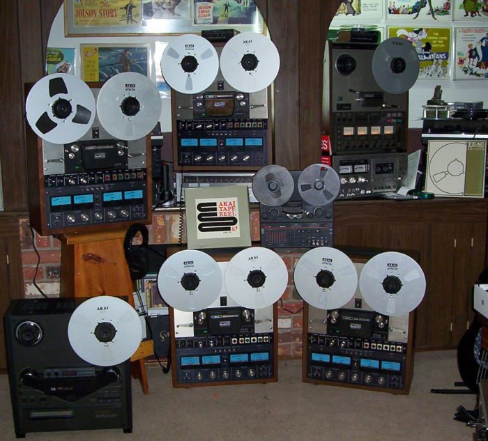

Here is a picture of his collection:
Vintage TX , Thanks for posting pics of reel collection. I have not seen a GX-400 DSS with a black face! Pretty cool. Mine is the all brushed aluminum front. Very impressive collection! I am in need of a right tensioner arm in particular. It seems both tensioners have excessive play in and out although it may be normal. I should add this is not the reason the deck is not working. Thanks again for the post!
