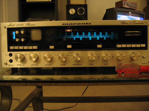

Well, as my SR9000G nears completion, i decided to pull the 4400 from my setup to evaluate it.
**aside**I bought the 4400 on ebay on accident since I didn't think my bid for 400 would hold up. I just wanted a unit with a working scope, as thats the only part I know would be IMPOSSIBLE to find. It was my first vintage audio purchase, and I thought since I was getting the king of quads...i would not need anything else. Needless to say, i ate those words. **aside**
The 4400 had two obvious problems, the scope had a curve tracer like display. And every time I would play it, there would be a loud pop, the speaker protection relays would kick in, and reset the unit. The pop would not comeback the rest of the listening session. I lived with both problems by playing low volume till the pop, and dimming the scope to prevent burn in.
With any good restoration, you take lots of before shots, and measure offsets. The dial lamps were not all there, so I have LEDs ready to put in as a final touch.
I took offset measurements and was pretty happy with the results. The range was from -.15VDC to .114VDC.

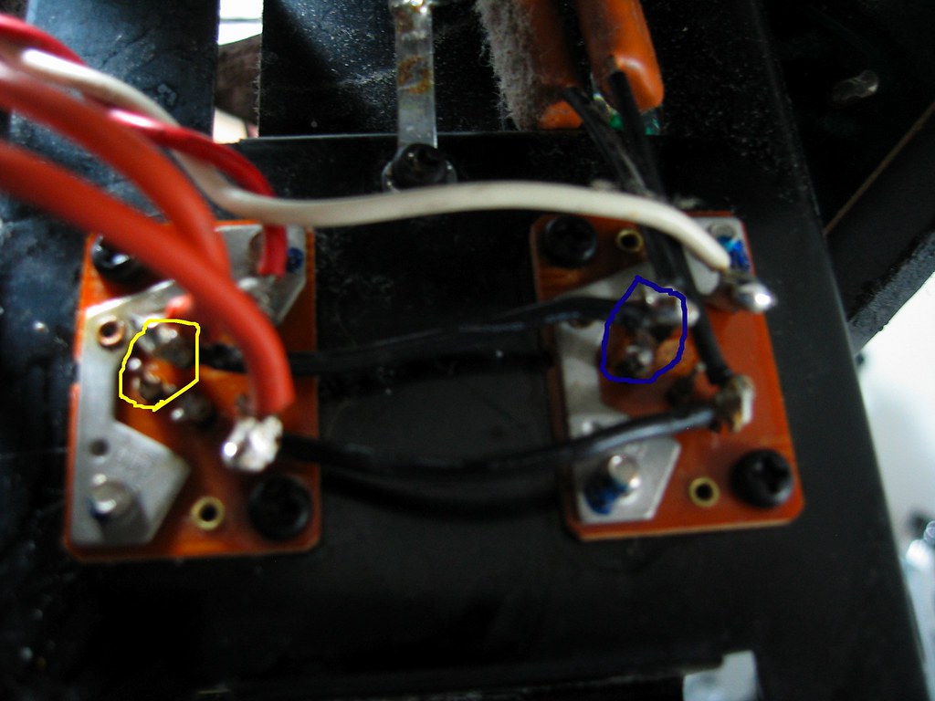

I have a question about the main power diodes I was supposed to check. There was in fact a sleeve that slipped off its pin. I placed it back and soldered it. It seems the diode board on the right has a different configuration, unless there is a bridge missing. Basically, is the connection circled in blue supposed to be there in the part thats circled in yellow. The pins in blue are connected, the pins in yellow are not.....anything wrong with that??
I really can't tell from the photo....Why not just replace the sockets to be sure....
jk
I still wouldnt know if the connection is proper.
Basically, the pins circled in blue are connected, the ones in yellow are not. Should the two pins connected in yellow be connected to each other.

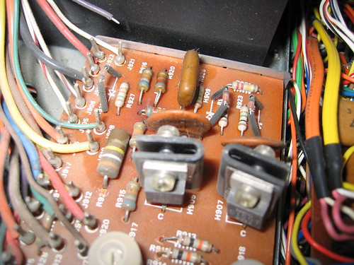

I replaced all the caps in the power board and amp boards except for the ones I forgot to order :rolleyes: On one board however, i noticed that a transistor had been replaced, and its heatsink/spacer was missing. The originals are 2sc627, the replacement is a NTE154.
1) Do I replace this one, or replace them all with something better (suggestions???)
2)What is the white spacer underneath there for? It is missing on the replacement, but the other ones have it. Where can I get it?
3)I still don't know what to do with the diodes in my above post, anybody have ideas or need a better explanation of the question?
Transistor in question.

I got your PM, but I'll answer here...if you're measuring the proper voltage on the 20,000µf caps, then the diodes are wired properly (but yes, it looks a little sloppy on your unit). If the diodes were NOT wired correctly, sparks and blown fuses would rule the day.

crap....thats the issue. I know the unit was working before, but I don't know if i broke the connection on the diode while taking it apart. So basically I need to test the voltage, but to test the voltage it needs to be plugged in. But when its plugged in and wired wrong, lots of bad things will happen.....:tears:

I have the SM but cant find where the diodes are mentioned other than being part H009 and H008. The unit never blew fuses, im just afraid it will if these diodes are now connected wrong. Ill pull the main boards and see what happens when I plug it back in. If no kaboom, ill install all the cards.
