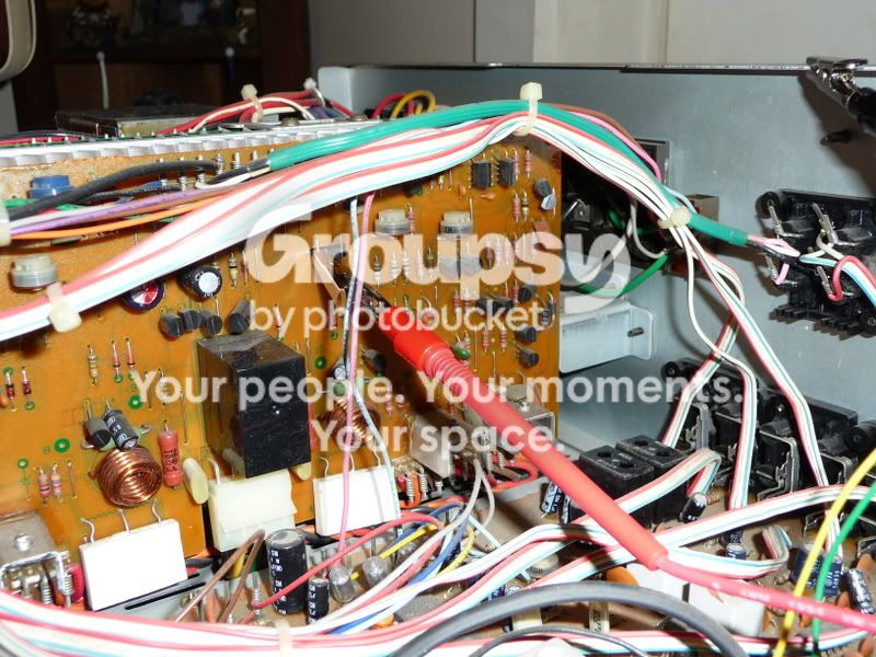

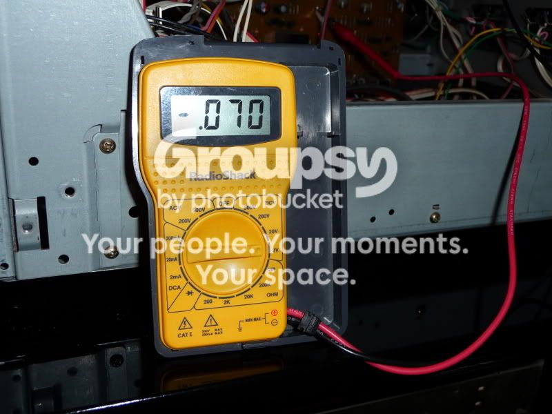

Please excuse my ignorance in this matter, but I want to make sure I'm doing this adjustment correctly on my SX-D5000. Page 25 of the SM gives the idle current procedure that includes adjustment and measuring points. The measuring points on this model are at the bottom of the board and are difficult to get at. The SX-D7000 has the identical board, but the manual instructs measuring points at the cut-out test area, which is much easier to do. After careful measuring, I've determined that the cut-out of the SX-D5000 are the same as the published measuring points (28, 25, 20 & 17). Also, I'm wanting to verify I'm reading my DMM correctly. The pic shows the DMM measuring test point #20, with a reading of what I believe is -.070mV (SM calls for 120mV) at this point. Finally, why would the D5000s SM call for measuring points much more difficult than the D7000? Again, my inexperience shows, I'm still trying to learn. I did adjust to specified points per the SM. Any guidance is appreciated (I will insulate the probes better--promise).
DMM reading
DMM lead at measuring point 20, other lead grounded at chassis
thanks
FIRST and foremost, measuring idle current DOES NOT involve connecting to a ground!! WHATEVER you adjusted it to, it won't be correct with a ground based measurement. In fact it could be dangerously (to the transistors) high....
Why in the second picture isn't the second probe connected to the other wire spanning the square hole in the board??
One DMM lead (red) is to be connected to pin 28 (or 17 on the other channel) while the OTHER dmm lead (black) is to be connected to pin 25 (or 20 on the other channel) . THAT'S how...
As to why, it's easier to name a pin rather than reference "the square hole in the board". I suspect that there was a fixture that mated the hole during production, that when pushed in, hit the wires and made it possible to read the value faster. No possibilities of measuring the wrong spot or SHORTING pins with a probe at production speeds. Later they relented and TOLD us about the shortcut (maybe they were afraid of someone doing what you did in the picture - shorting danger is HIGH) , OR a different group of people wrote the other procedure.
As to why the reading you are getting (if it is wrong WITH your corrected measuring procedure) , you need to read the two voltages AT EACH HALF of the dual emitter resistor. The center wire is the output terminal, the two outside connections are the pnp and npn output transistor's emitters, pins 25 & 28 (23) or pins 17 & 20 (22). The output is () but there's a coil/resistor combination as well as the protect relay contacts between that pin and the actual resistor lead where the reading counts..
