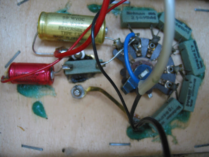

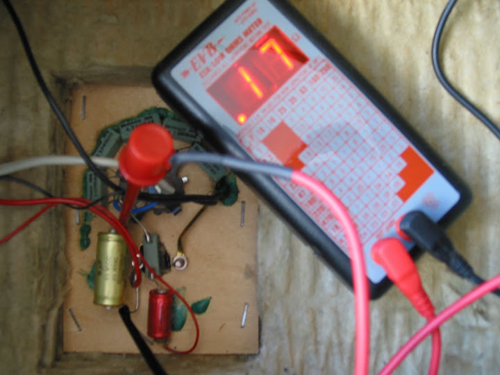

Pulled the drivers this morning... this is my first speaker restore so not sure if I'm doing things right so any help/comments very welcome!

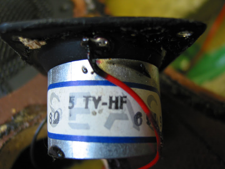

Yes, Rolf, it is SEAS 5TV-HF - Woofer is H336 and the other tweeter is Type Dome 87 H
Here is crossover filter
The big cap is 8uF/50v and the little red one that feeds the 5TV-HF is 1.2uF/50v
What is recommended as to replacing them? I checked ESR and it seems OK. I measured a few of the resistors and they were not too out of spec

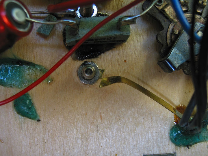

As this is my first time to open a set of speakers of course I managed to break something :) ... the flat brass connector to the negative terminal. Is this some kind of fuse? I don't suppose you can solder it together? I hope I haven't screwed things up! Thanks for any help.
