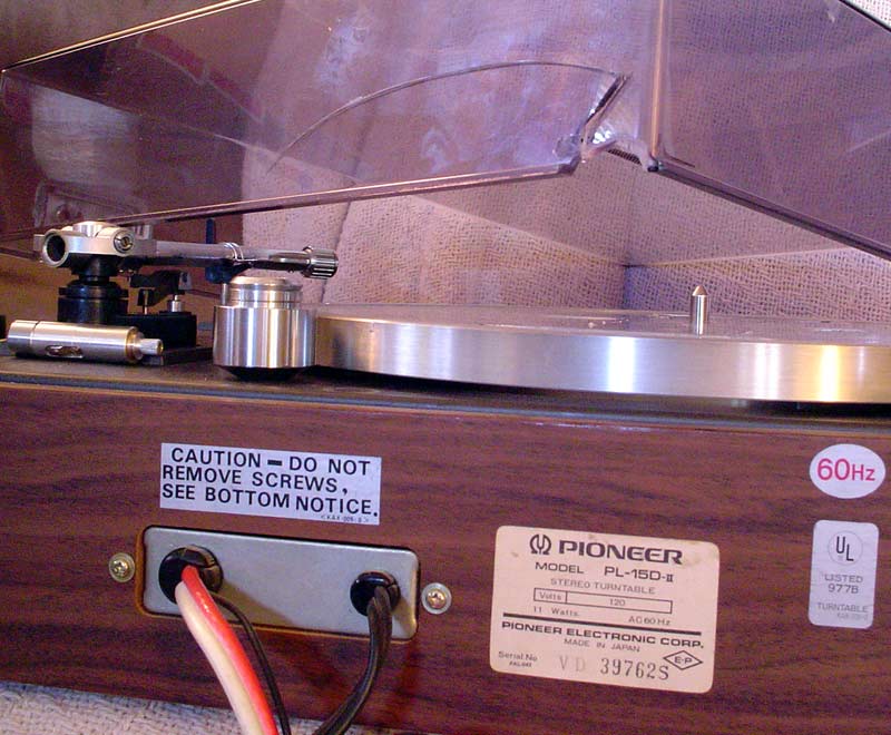

Before you do anything else, Remove the dustcover, platter, and belt.
You should just be able to wrap the belt around the metal underside of the platter, and that way it wont be under tension and possibly break during shipping. Set these aside till a bit later. If the Platter is not removeable,
slip cardboard shims under all edges of it to keep it from destroying the deck.

Prior to cutting the foam sides, you need to pre-pack the turntable and measure how high the end result is.
To pre-pack it;
First, tie down the tone arm with one or two twist ties to the rest.
Dont go too tight and break the rest, but make sure the tone arm cant go off the rest.
Edit: Next, I remove the counterweight and the headshell.
For the headshell/cartridge, sandwich it sideways between two pieces of foam to protect it, then tape it together around the edges of the foam, to immobilize it. Then put this all in a ziplock bag. It's worked for me in the past. Bubble wrap the counterwight and make sure it's taped down securely somewhere.
(When I first wrote this guide, I had not removed either, but at the advice of many others i realized it would probably be wise. Better safe than sorry!)
Next put the entire turntable inside a large trash bag, taking care not to damage the tone arm in the process. Tie off the end. This protects the inside of the turntable from getting anything inside which doesnt belong, and allows you to tape around it.
Then, get a small and strong cardboard box, generally something in the 7x7x6 size range. Poke a small hole in the underside of the box, Then slip it over the bag and the spindle.
IMPORTANT :Take care not to put pressure on the tone arm by inadvertantly pulling the bag tightly across it while taping the box down in the next step.
Now use a lot of tape and secure the box down to the bag very firmly. Since you cant generally tape across the tonearm side, the other three sides will need a lot of taping around from front to back, and on the end, to ensure that nothing can move. Wrap tape from the front to back of the deck and underneath, giving you a tightly wrapped band all around, as well as to the non tonearm side.
You do not want the box to spin slightly left or right on the spindle, and if the turntable has a internally suspended platter, tightly tape the box down until nothing can move.
If everything is shaking around inside during shipping, you could damage the motor, suspension, or other internal parts.
Some turntables have transit screws, but not all. If your has them, make sure to tighten them down prior to anything else.

Nice information. Acouple of thoughts:
I notice in the picture your tonearm counterweight appears to be still attached. Shouldn't this normally be removed and shipped in separate packing. (Headshell too).

Hey Cgutz,
I usually dont remove the headshell or counterweight, I've never had a problem with it since the tone arm is immobilized. It could certainly be done as an even more precautionary move.

Looks good. However, the counter weight and headshell should be removed, or at minimum supported. A large G force could put stress on the arm and bearing with the added weight still attached. Just my 2c or course. :)

One more vote for removing the counterweight and headshell. The extension it mounts to can have a fairly fragile connection at the pivot point depending on the table design. The friction ring that holds it in place could also fail with the right shock. Even a fairly lightweight headshell/cartridge combo packs a lot of inertia. Once it's loose ... abandon all hope ...
Once both the headshell and counterweight are removed (and again packed OUTSIDE the dustcover, a simple garbage bag tie around the arm and support should be plenty - we're not talking a lot of weight at that point. Blue foam is your friend here ... you're already using it to protect the table - just cut some holes here and there to stash the headshell, weight, spindle adapters, and any other removable components you don't want breaking loose.
Also, read the book. If there are any shipping screws or locks built in, definitely make sure those are set properly, AND that the buyer knows how to defeat those once it arrives.
