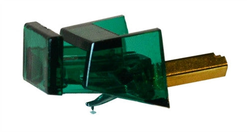

I have here an Empire 4000 XL III cartridge that I bought new in about 1980. It wasn't too expensive back then - about $40-$50. Can't find any doc for appropriate tracking force etc. I remember audio mag reviews that it was a bit of a giant killer at the time though.
I'm using a Shure M55E with a new Jico stylus right now. I hate swapping carts around (end up breaking leads, boo) and the Empire has a pretty flaky mounting system.
Anyone know anything about these things? I find lots of info on other members of the 4000 family but not this one.
It's the stylus that determines what tracking force is needed and also determines the "sound" of the cartridge. What stylus is in there now?
Aha, the S912E stylus, as Empire called it. Here you go.
3/4 to 1.5? Pretty light tracking. I think I used to use it on 1.5 with my sadly departed Technics SL-20. Decent cart & stylus you think? Superior to the Shure M55E or no?
Yes, decent. 0.6mg effective tip mass is hardly state of the art, but good enough when part of a decent design, and within the constraints of price and production, to give you good tracking at 1.25g.
Technically, yes, it's superior to the M55E. It should be, it's about a decade newer. Does that guarantee you'll prefer the sound of the Empire? Not at all.

Looks like 239-PDE is the Empire replacement for the S912E.
239-DET is similar (.3x.7 rather than .2x.7, replacement for S915E) and is readily available.
(edit: whoops, found a note that 239-DET is not interchangeable).
Great to find the knowledge base here!
This cartridge is not related to the original quad series, the 4000D/I,II,II; after a certain time, Empire's model numbers became completely random and the same three bodies were remade and rebadged over and over.
However, it's not hugely different from them.
While the 4000 XL III might actually work for CD-4 (the coil inductance is low enough), that wasn't the original intent, and the S912E is not a quad stylus. You can, if you can find one, use a 4000D stylus in the 4000 XL III body, but it's far easier and cheaper to find and buy the S912E.
Even if this was a quad cart, there's no reason you shouldn't be using this cart and stylus for stereo.
As you say, the 239-DET is a special stylus (Empire name: S915E) designed only for the 2000Z and its clones. 239-PDE (purple) is Pfanstiehl's index for the S912E. These two 239s are not mechanically or electrically compatible. That is, the "239" designation isn't always able to distinguish incompatible from compatible. So be careful when using the Pfanstiehl index system. You can never assume anything will be completely logical. Welcome to AnalogLand.
