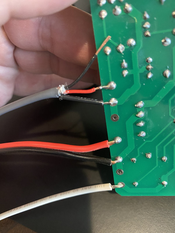

On the amplifier circuit boards, I’m installing wire. The shielded grey wire with three wires inside (drain wire, red and black). The instructions clearly state to attach the red to IN and the drain wire to the INGND spigot closest to the IN. It does not say what to do with the black wire. I figured it would attach to a harness later but in finishing the harnesses I am not seeing what to do with it.
Here’s a pic.
On edit I may have located the cause of my conundrum. In the wire preparation text at the end it states to pull the black wire out of the shield completely. I mistook this as relating to pulling the insulation off of the solid black donor wire to install onto the drain wire.
So as I understand it now the black wire gets pulled completely from the shielded wire and is unused.
I had to read that section several times - it says to pull the black wire out of the cable, altogether. Which was surprising to me, but obviously Dan Joffe has gone through the alternatives, and this is the best way.
The black piece of insulation from the solid core wire, that you slide down over the drain/shield wire is the other surprise - I think that is done so it can be identified; and to insulate it where it is exposed.
