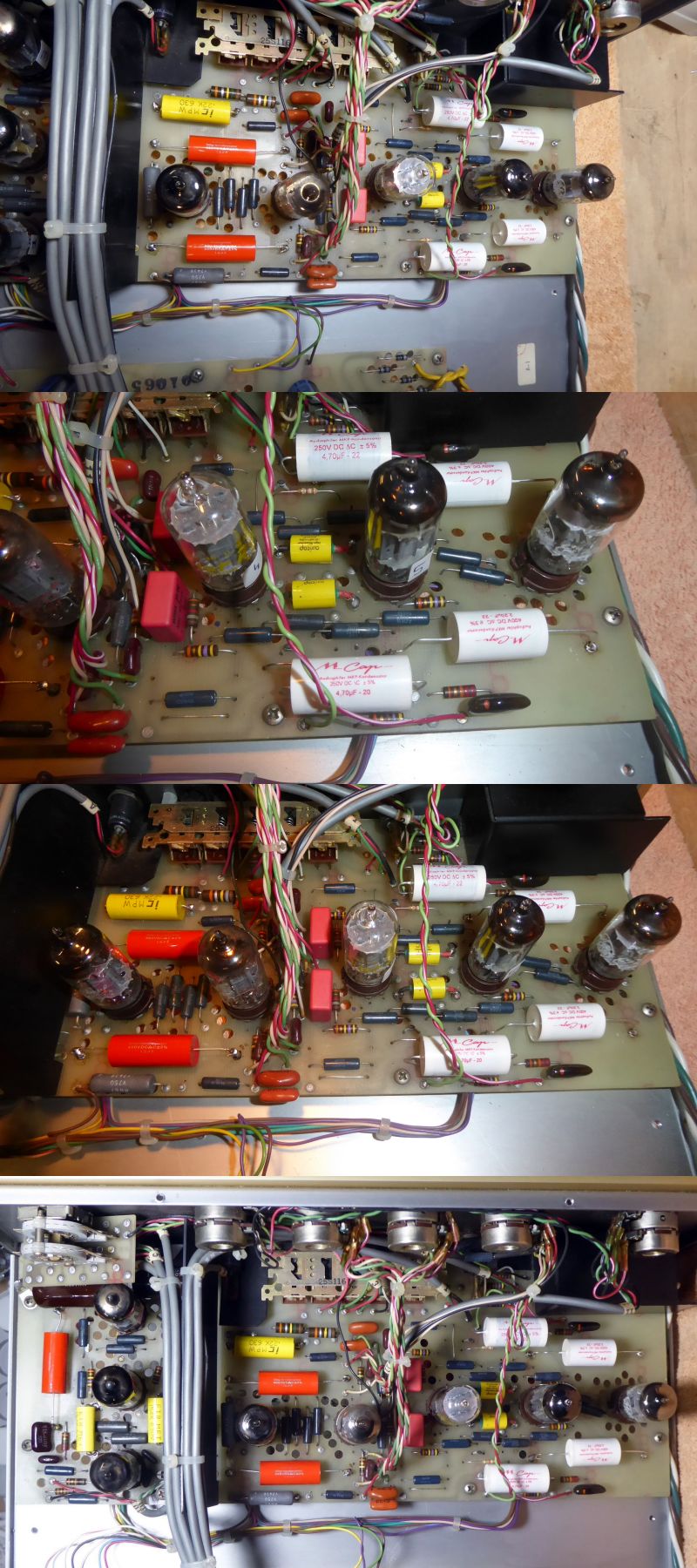

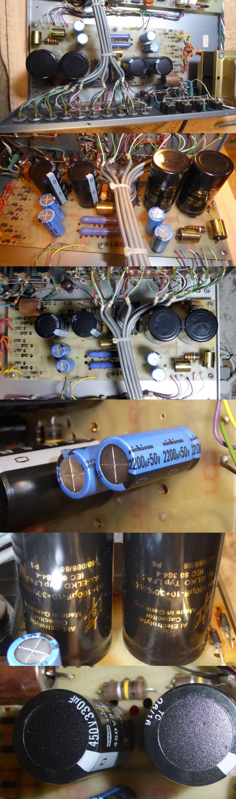

Just a couple of weeks ago I found another SP3 marked with the factory paper "A-1" sticker that was botched by someone and modified with pseudo Curcio mods and with 12Au7 s (?) in the line section. Any way I have reversed those kludges and so far rebuilt the power supply.
I was going to re- stuff but I managed to just use snap ins for the heaters and Kemet makes a very nice 550v cap for the first stage- then Mundorf 200+200uf for the decoupling.
Some holes needed to be drilled under the original cans to makes these fit but it turned out very neat.
SP3's have many variants on the PS boards - this one had an SP3 A amp board not SP3 or SP3-A1 -so a little different than my previous one. It was upgraded to A1 status by the factory and noted by the sticker.
The amp board in all models are virtually the same with just some parts deletions or value changes to get from SP3 to SP3 A to SP3 A1
This one is not as beautiful as my old black and gold- but I will make it electrically sound.
Next is tube sockets and various resistor and cap changes - as I test. Lots more work.

I was taking voltage readings last night after the PS upgrade. Some on V1 and V4 were well off on the plates.
Everything else lined up. This evening I began taking resistance measurements. the plate resistors on these tubes were SP3 values at 150K and not 301K like the SP 3A (A1) and the voltages were high.
This will bring things in line as there will be a greater voltage drop across the larger resistors ( more gain too).
as it has the SP3 A 1 sticker on the back and inside by the transformer. Weird.

Here's why my voltages were off if anyone runs into the same issue. Plate resistor on v1 and v4 150k vs 301k on A-1 and cathode resistor on v301k instead of 100k
Also the feed back network is definitely A1 and this I believe with the PS was the major mod at the factory
My PS board is SP 3A1, my feed back circuit is 3A-1 and my phono and first line stage section SP 3 ---sheesh.
The punched SN is A the sticker is -A1 My guess is that it was an early A1 factory mod --- there were lots of changes
so it sounds like they increased the open loop gain by increasing the plate resistors, but compensated that with more feedback so the end result is the same as original ? That should reduce distortion if so.
A strange set of changes.
The situation is that on mine the feedback network is like the newest A1...this may of been part of the update as the resistors are definitely factory.
I am waiting for a few parts and will chime back in soon.
Depending on actual needs, maybe thats not a bad mix. No idea what the gain of the line stage is on these things, but if the source is hot and the amp has reasonably high input sensitivity, having lower gain in the preamp may have an advantage. More feedback but less open loop gain makes for less gain end to end.
