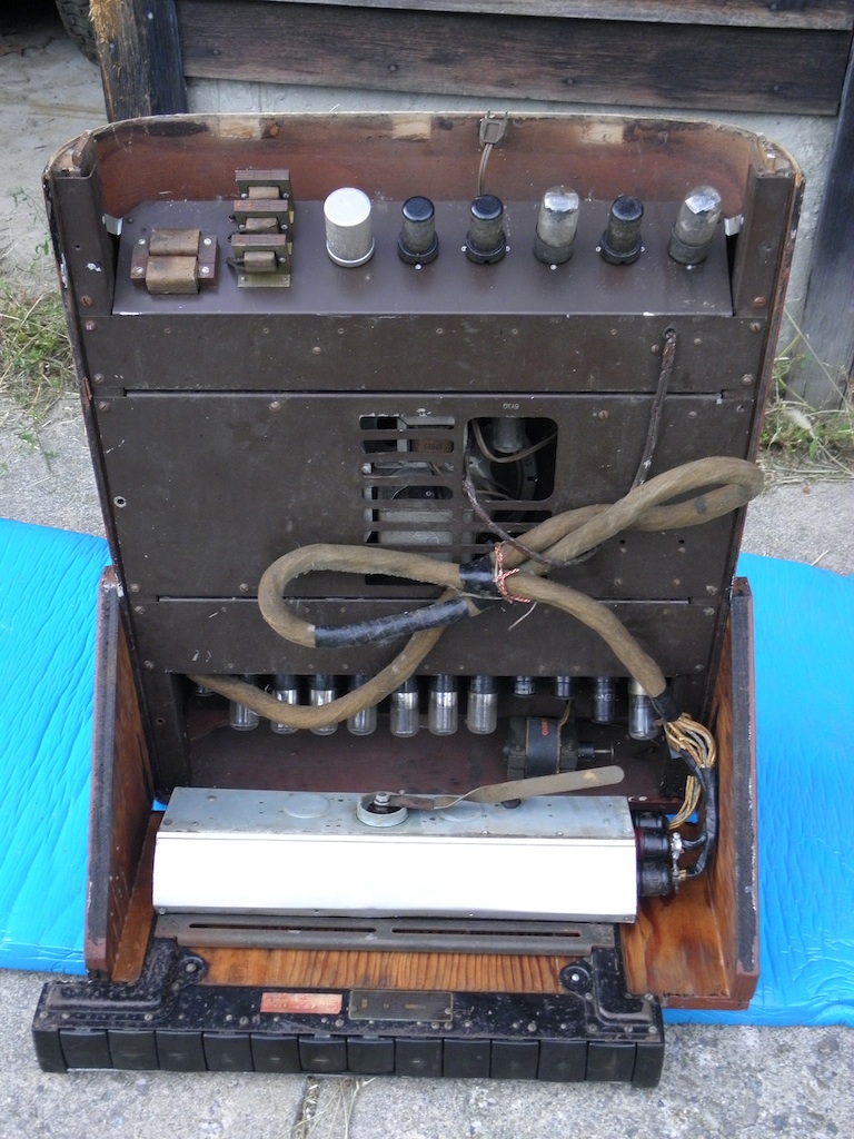

I purchased this organ today from a local thrift store for the price of a pizza. The power cord is pretty frayed so unsure if it works. Any info on this amp Model 51-51p?
I have never seen some many 12au7 and 12ax7. All of them labeled Baldwin but some are yellow and orange made in Japan and green made in USA .
Can this amp be converted to be used as stereo amp?
The amp is mono so only one output transformer. Plus, you will have to have some electronics background to know how to separate the amp from the chassis.

Yeah, I definitely need more than the 4 years of high school electronics I had . I pulled everything out of the organ. I even found a 1964 silver quarter!
Underside of the 51p amp .

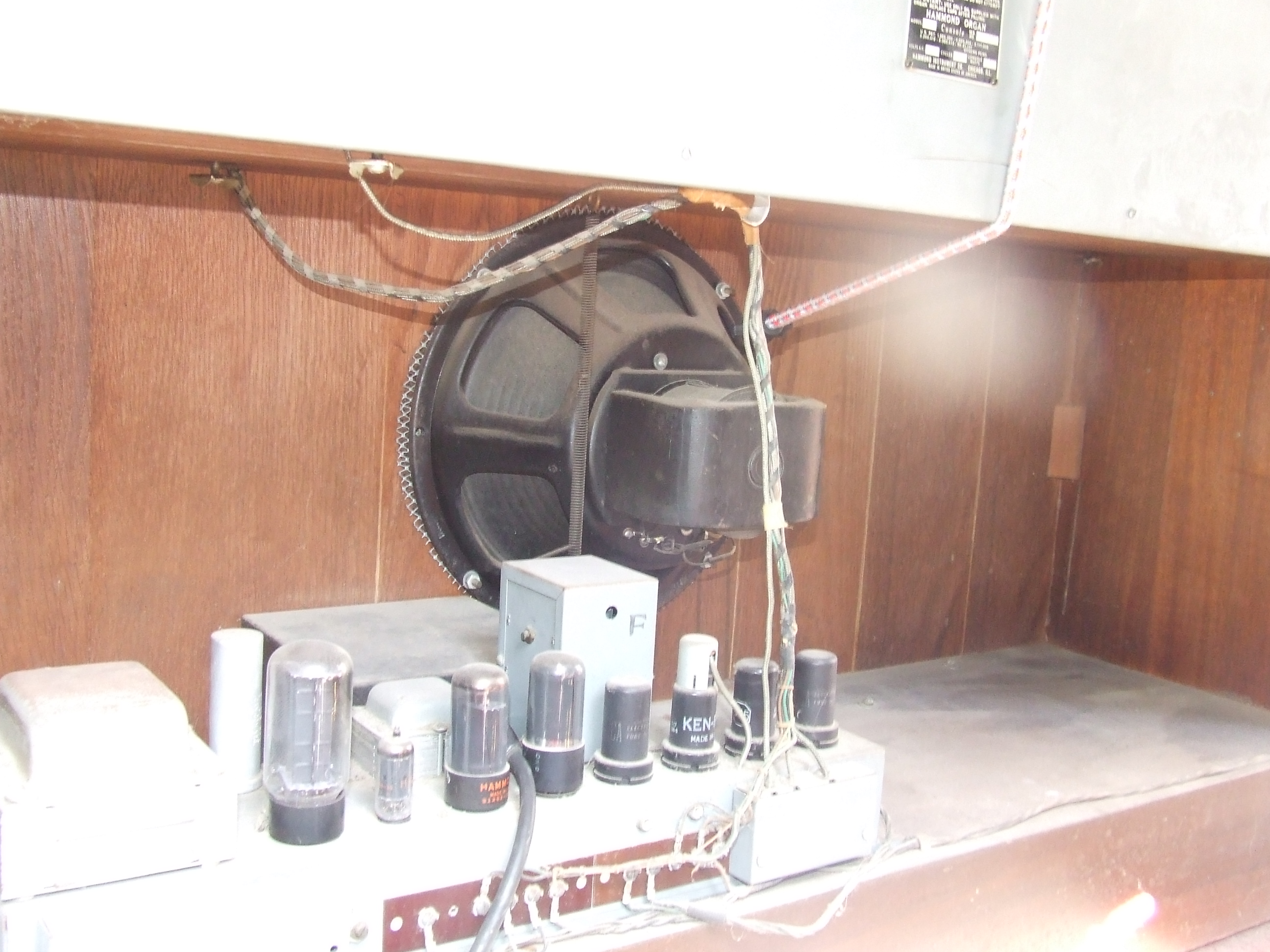

A couple of nice 6L6, a bunch of quality 12A_7s, a (IIRC)5U4 Rect, Heafty PT and PP OPT, and IIRC a PS choke. Very useful stuff if you don't need a spinet organ. There is also a bunch of interesting iron in the tone generators that might be useful if you are equiped to ring it out and see what you have. Interesting cores if nothing else if you can wind your own.

As inferred above, it is relatively easy to separate the tone generation sections from the amp itself. Think of tone generation as one or more source inputs, which can replaced by an input jack. Also as noted, there are components in the tone generators that are definitely worth saving. In addition to what was noted, you may have some caps desired by the vintage guitar amp community. If so they can possibly pay the cost for the entire amp purchase (of course the 12AU7 and 12AX7 tubes have already done that).
As far as a matching amp, you should check some of the other Baldwin spinets from the same time (numerous 2-digit models between 30 and 61). Make sure the amp is also a 6L6 amp, as some of those models were 6BQ5 amps. The key is the iron, so make sure to note the transformer numbers and make sure they match. These amps can often be found on Ebay as singles for as little as $100 shipped.
I forgot to ad that you should be able to find a schematic for the amp. If not on A/K, try searching organ forums as they have a lot of documentation.
