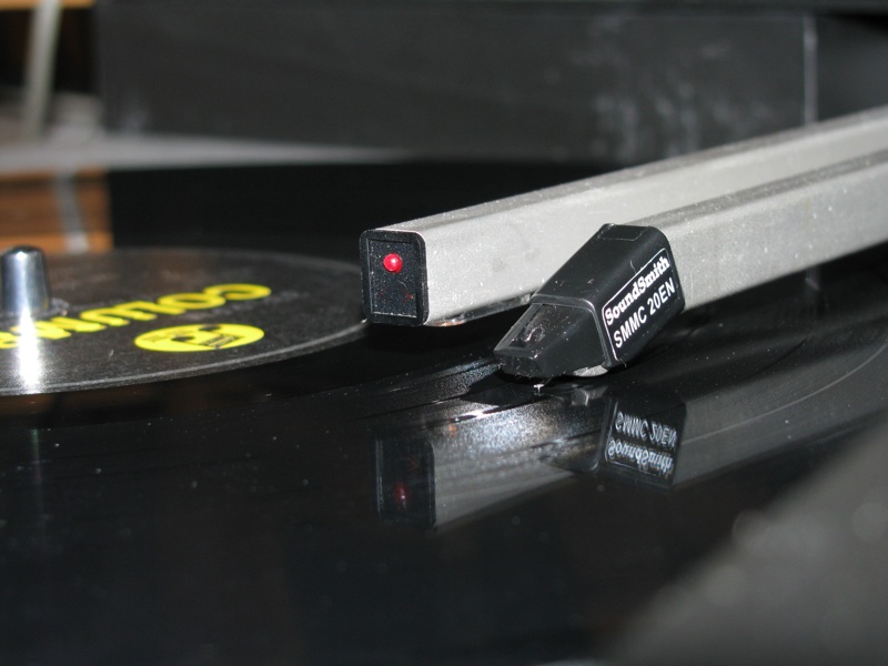

I've owned several Beograms, and though they have their quirks, they're geerally excellent turntables. I don't have a TX, but I have a 4002, 8000 and TX2, the latter of which I use on a regular basis (the other two need repairs, but I'm hoping to get them working soon). My Beogram 8000 is equipped with a SoundSmith SMMC20EN (nude elliptical stylus), and it sounds pretty good. Once I get it back from repairs, I'm planning to compare it with an original B&O MMC20CL cartridge I picked up recently.

Again, you're buying an entire cartridge rather than just a stylus, so factor that into the equation. Also, they're very nice-sounding cartridges when you get down to it, and the stylus lasts a good long time. I bought my SMMC20EN (SMMC3) in 2010, and it's still going strong.
