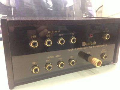

The C33 has only a MM (moving magnet) capability. If you wish to use Moving coil low output carts then you will need a step up transformer or a suitable external phono stage connected to an AUX input. DO NOT connect an outboard phono stages line level outputs to the phono input of your C33.
I suggest this for low output MC carts

My old tt uses a Sumiko 2.5 mV MC and sounds good through the c33 phono stage. But the carts I've been looking at are .2 & .8mV. and are probably not worth considering from what you say here, unless I want to buy a new phono stage (which I can't do this year, as I have already spent my wad on a new tt.
So a good choice for a new cart (using the c33 stage) would be a high output MC, or go to MM.
