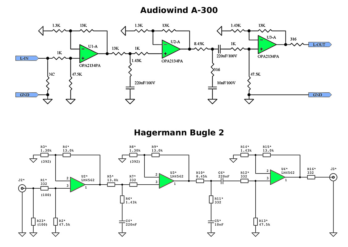

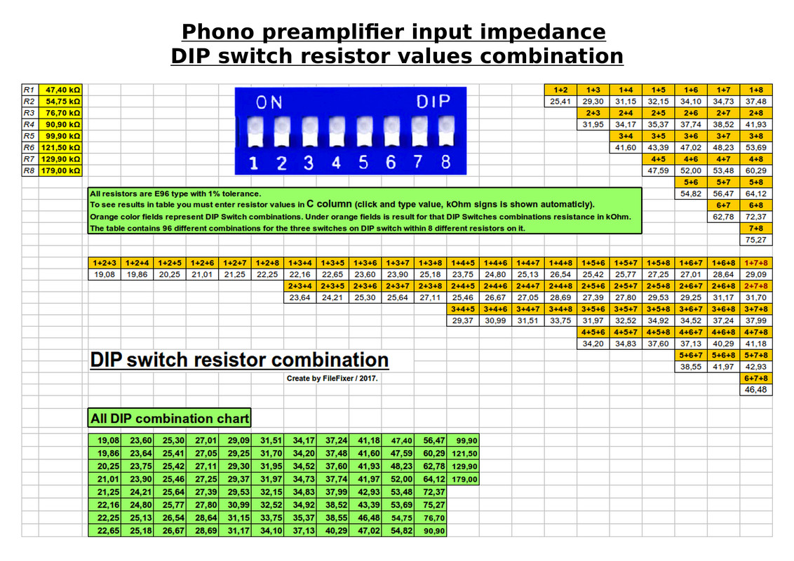

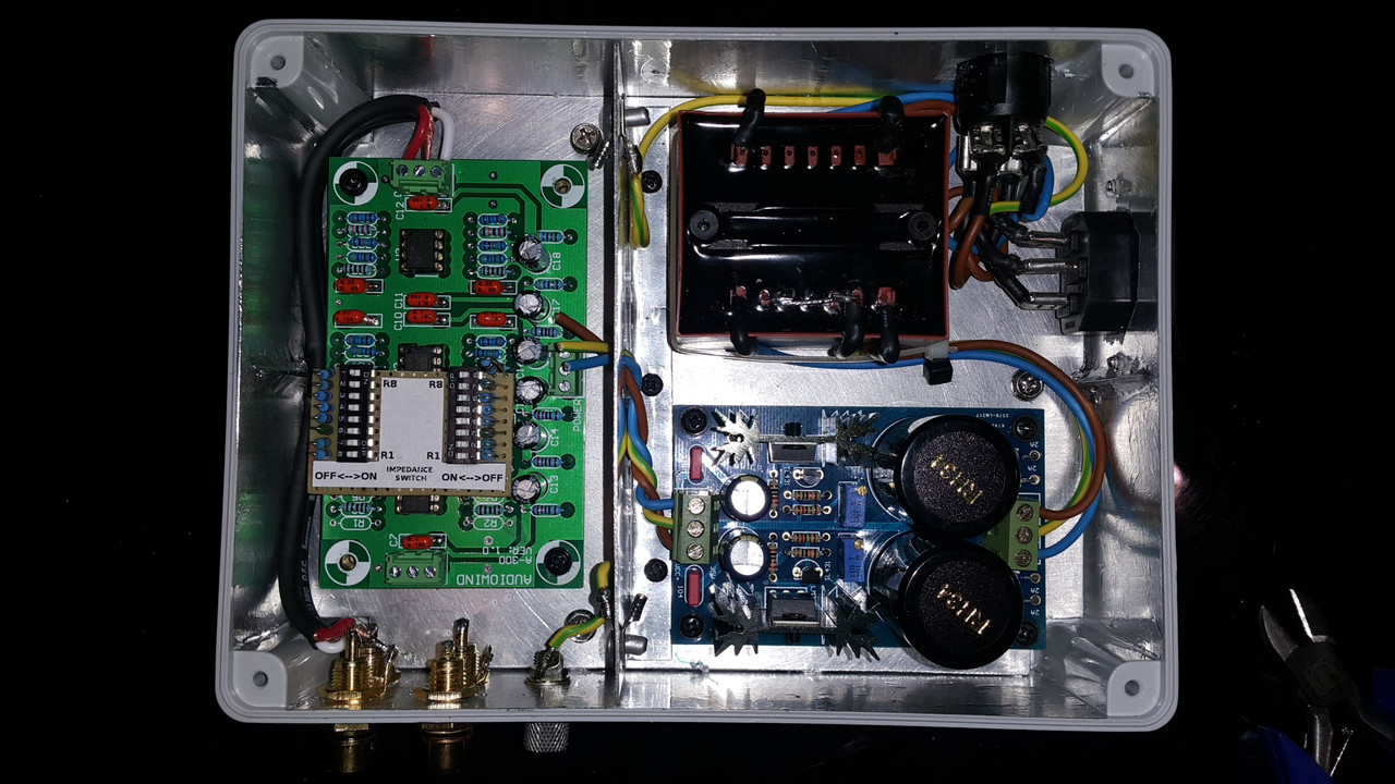

$80 DIY phono preamp with adjustable imput impedance. It have noise at 91dB what I measured with osciloscope. Audiowind A-300 use same schematic topology as Bugle 2 with different Op-Amps (OPA2134 vs. LM4562) but you can change Op_Amps. Mine preamp have 96 different input impedance choices with 3 DIP switch combination. It work Great on all MM cartridges and it is wery flexible for any cartridges.

Audiowind A-300 and power supply (LM317 LM337 + TL431) from ebay. All other componets from my local electronic store.
Add in search line on ebay this...
Stereo MM Phono RIAA Preamplifier Module Board, OPA2134
You can find many different versions with LM833 Op-Amps but OPA2134 is way better then LM833)
LM317 LM337 + TL431 power supply
TL431 is shunt for better power suply performance and lower noise.
