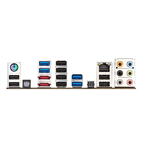

I have a custom built PC with a decently high end motherboard. My understanding of the onboard soundcard is that it is pretty good. You can see my assortment of inputs in this pic:
So it has the stuff for surround analog; but I guess I'd need something to go in between. Like an... ADC (Is that an acronym?)

An ADC is an analog to digital converter. I don't think there really is a separate unit for surround (if there is, likely expensive) and it's really not necessary at all. Like I said, if a receiver has multichannel analog inputs, you can just directly use those with a line to RCA converter for each channel. The receiver would have an ADC built in in that case, so no need for an extra one.
For all intensive purposes, the digital signal coming out of the optical input is the same as the signal going into the DAC (digital to analog converter) of your soundcard before it is converted to multichannel analog, so using the analog outs with an ADC is a really roundabout way to get the same result. Since your Pioneer takes a digital signal, it has its own DAC built-in, so no need to use the one in the soundcard. The "pretty good" rating of your soundcard or any soundcard would be from its DAC and analog outputs. Optical outputs or digital coax outputs should be the same across the board, so that's why you can go with a cheap soundcard as the analog outputs would be superfluous for you.
I hope that makes sense.
