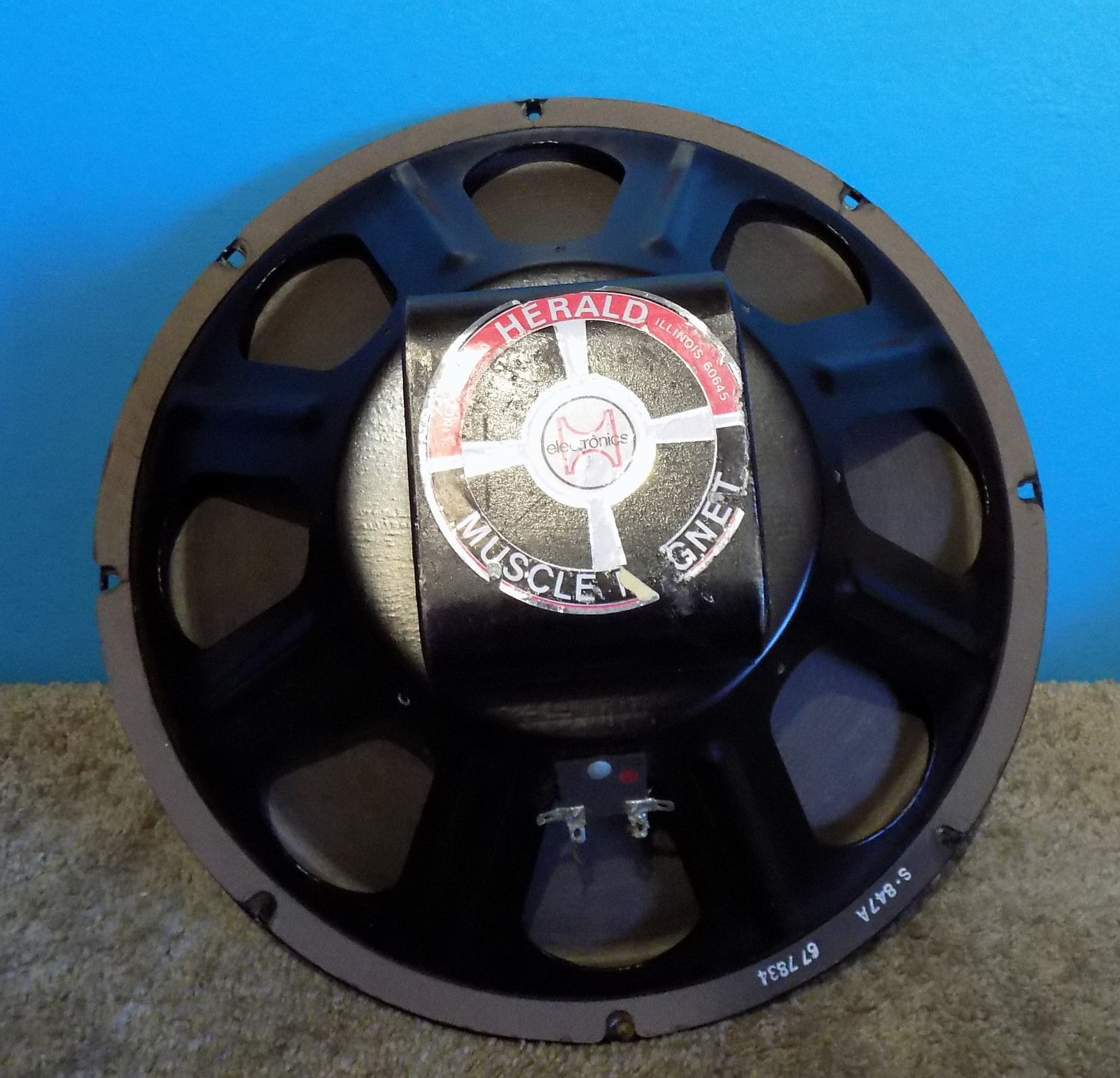

What can you tell me about Herald woofers? I have a 15” pair in mint condition. Just wondering if they are worth doing anything with

I'd be willing to bet that your 15 inch Herald woofers have either the classic square 54 ounce magnet or large open frame alnico motor, "muscle magnet" sticker, and were made in the USA by Eminence. Most of their large cone speakers were made by Eminence.
Look for the Eminence EIA code "67" on the rim of frame spaced just slightly apart from any other numbers to verify.
You will see the Eminence EIA on all these woofers:
They look just like your first pic. Big black square magnet. Are they decent woofers? They came in some big homemade cabinets that I got. There’s a bunch of different drivers in the cabinet, all wired together and full range. Sound terrible, but we’re good for refoam practice
