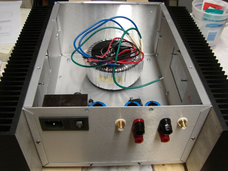

This evening I spent another couple of hours getting the chassis squared away. I mounted the feet, torriod, power supply pcb standoffs, rectifiers, RCA inputs, binding posts, and the AC entry module.
I also studied the power supply schematic and I believe I have a handle on it.

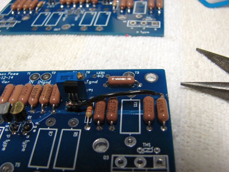

I worked on the driver boards last night and made a mistake by putting one of the transistors in backwards. Of course I butchered the one of the pads pulling it out, so now it looks like ass. For the time being I am going to hardwire that leg but its going to drive me nuts to know its there, so a new board is on order.

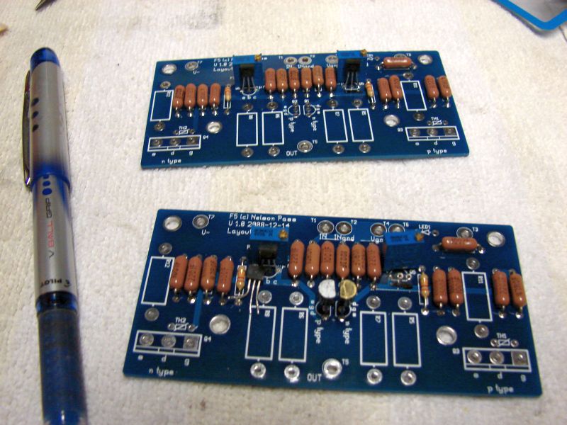

Here are the two driver boards with a pen for scale. Tiny, eh?
The damaged pad is the lower board, right in front of the trim pot on the right. The tranny that came out of that blasted hole is laying in front of the other one.
Here's the repair. Not quite pro quality but it checks out against the other board.
Now I suppose you are asking yourself: what's he gonna do when R11 comes in? I'm kinda wondering about that myself.

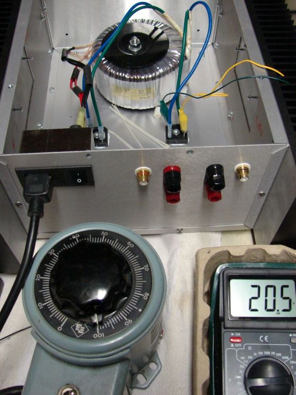

In other news, I powered up the torroid and rectifier circuit, both sides check out OK.

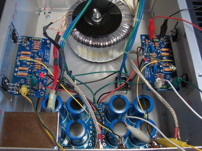

I was away for the weekend "up north", not at the fest. Last night I finished up soldering in the driver FETs and getting everything mounted and wired up. Lots of measure twice, cut once and soldering.
Here's what the guts look like.

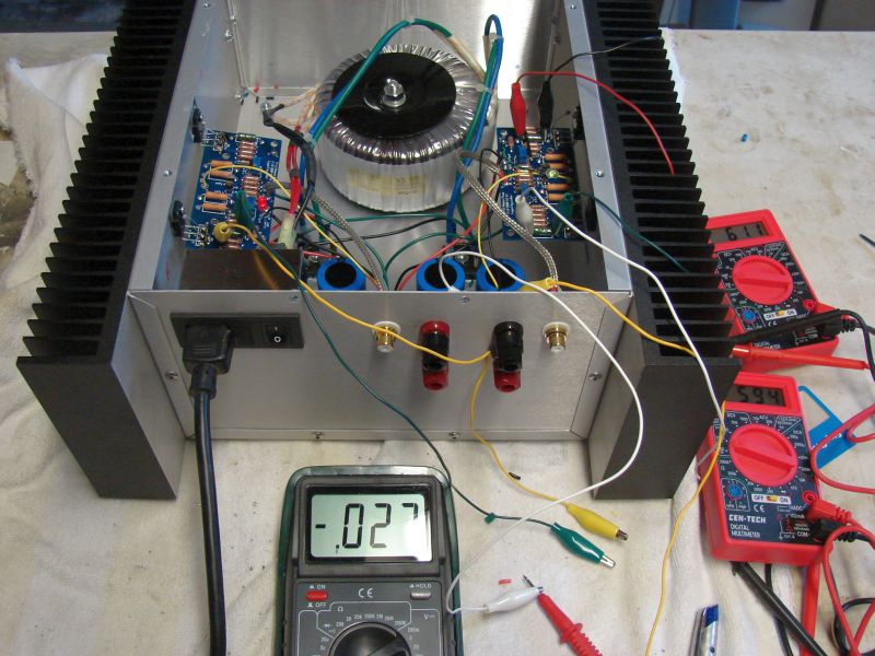

The instructions call for warming it up for a couple of hours prior to setting the bias and offset, so I let it run overnight and all day. Just at idle, those heatsinks get pretty warm.
Here I am getting close to correct voltages on the current measuring resistors along with tolerable DC offset. I had to run to Harbor Freight where I picked up the two meters for $2.99 each. I think I would have went nuts with only one meter here.

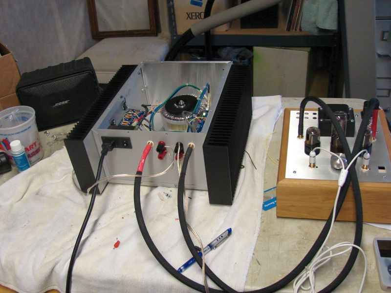

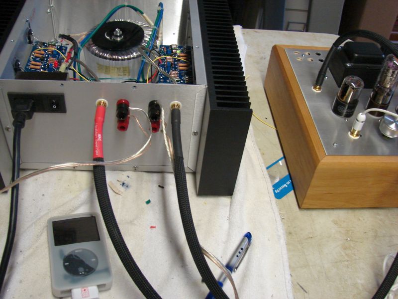

Finally everything looked ready to go. I brought out my Foreplay III and my ipod and a pair of Blose outdoor monitors that I use for tests. No noise, nice. First tunes up are what I always play on new gear: Little Feat's "Waiting for Columbus", of course!
It sounds like its supposed to, quick and clear. Not much critical listening with these test speakers though.
