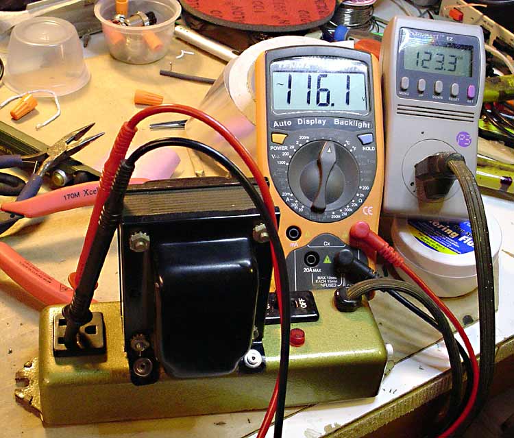

Most noticeable sq change here (other than drivers) was adding a bucker to the power supply - current VAC levels tend to be much higher than what these amps were designed for. Mine is a current gen clone (Latino ST120) and even that benefited a bunch.
