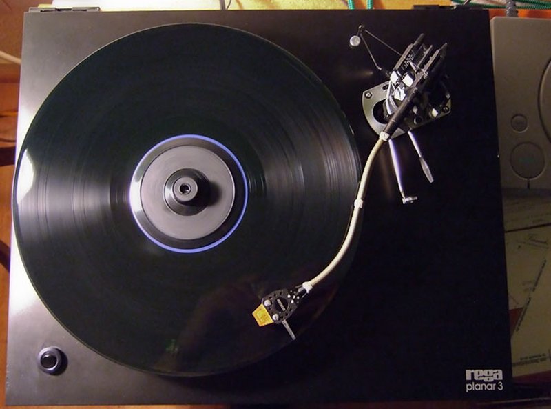

I have an SME III on my Rega Planar 3, it was the arm to have back when I bought mine, as Rega wasn't even building tonearms way back then.
It is still in great shape, and sounds great with medium to high compliance cartridges, which were all the rage back when this arm came out. It was SME's design for an ultralow mass arm. I used mine with a Grace F9E Ruby (both stock and presently a Soundsmith rebuild) and a Grado Blue and Grado Reference Sonata.
Right now, the Grace is in the SME III.
Here are some pix:
With the Grado Prestige 1 Blue
With the Grado Reference Sonata

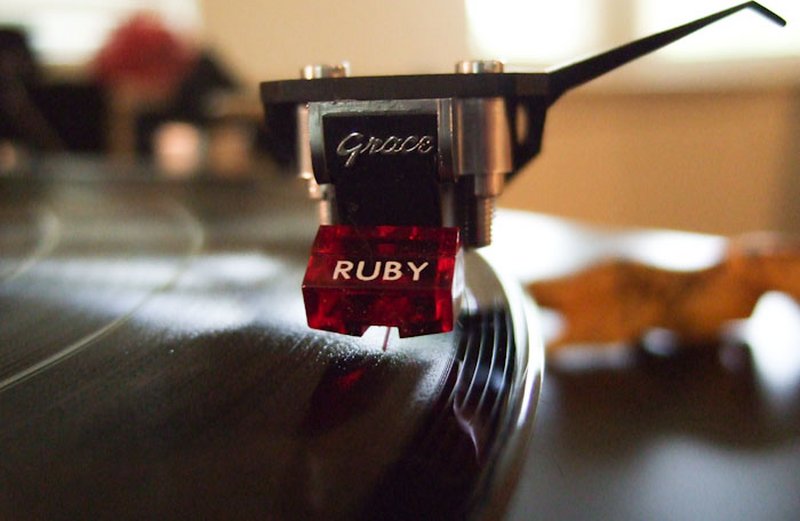

With the Soundsmith retipped Grace Ruby

That's pretty funny...if you heard my SME III with a Grace F9 Ruby retipped with a Soundsmith ruby canti and nude contact line diamond, the last thing you would ever think is that it lacked definition....
