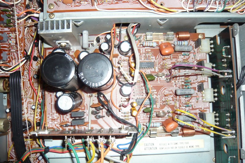

It may be just me but that filter cap on the left looks buffed out. If the unit stays on for a time then blows that cap is failing. I would also ASSUME ! that other related caps are going with it. Time for an overhaul.
