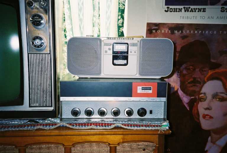

Bogen Challenger 50-w. tube amp
Uses 2 6L6-GC. I replaced all paper caps and sound is very good. It drives the 25-volt constant voltage sound system in my house. The only area where it is lacking is that the bass response is not as good as it could be...it uses a relatively small output transformer.
