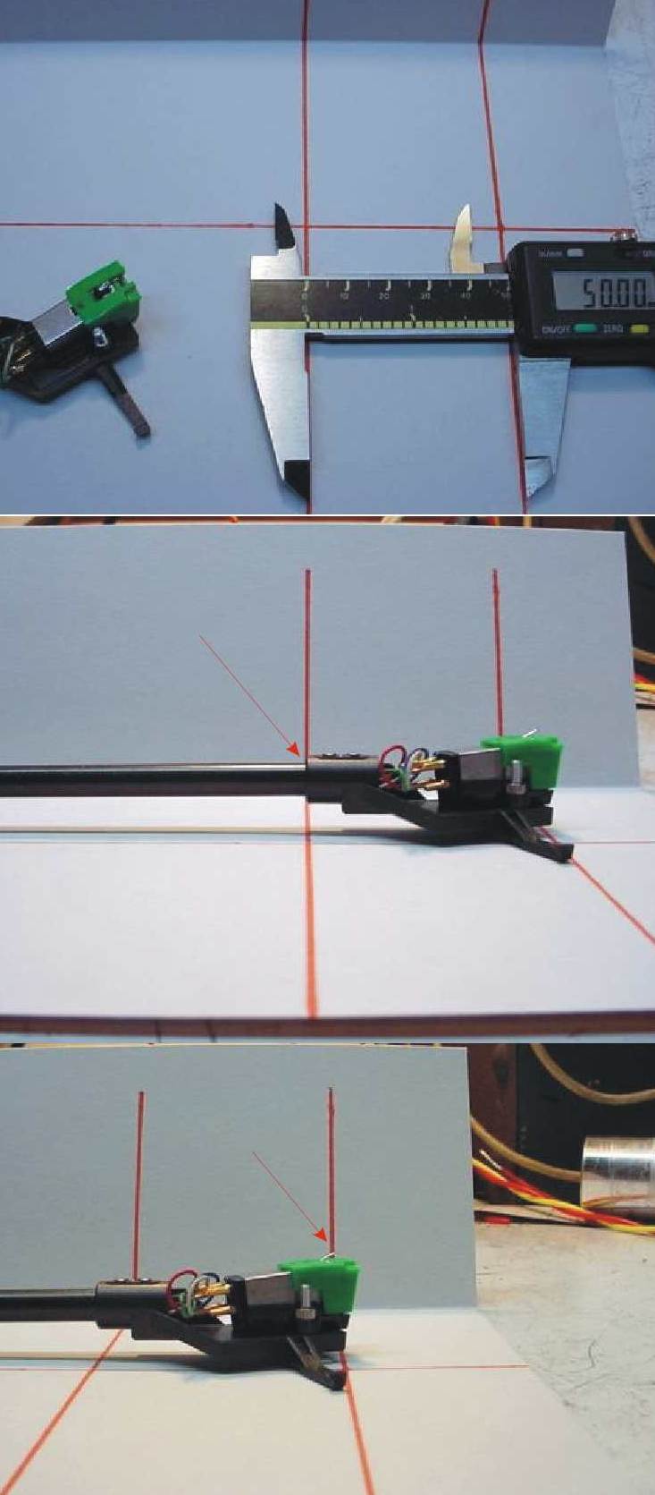

The manual recommends 50mm setup from base of the headshell to the cartridge tip.
The top photo shows the simple setup. Draw a horizontal line, then 2 lines crossing at 90 degrees, and 50mm apart.
The 2nd photo shows a dead on view of the headshell base aligned to the first line.
The 3rd photo shows a dead on view of the cartridge tip aligned to the 2nd line.
