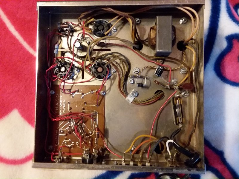

In truth, I have no idea what I am looking at.
You should add CL-80 or CL-90 thermistors on the AC lines coming into the amp. So one can be inline with the fuse, the other inline with the power switch. If you do a search on Dynaco Mark III thermistors, you will see pictures from people that have done this.
Great! Thanks! I was just about to try and search for this information and you have now provided it. I'll order the parts and get them in right away.
