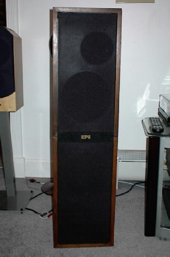

Custom-built pair of speakers I built for the chairman of Anime Weekend Atlanta. Based on two pairs of EPI100 cabinets 'siamesed" (opened up to one large internal chamber) to form one large tower. Top part contains stock (recapped/refoamed) EPI 100 complement. Has 8" passive radiator in bottom. Total cabinet volume of about 1.7 cubic feet. Bass down to 28 Hz!
