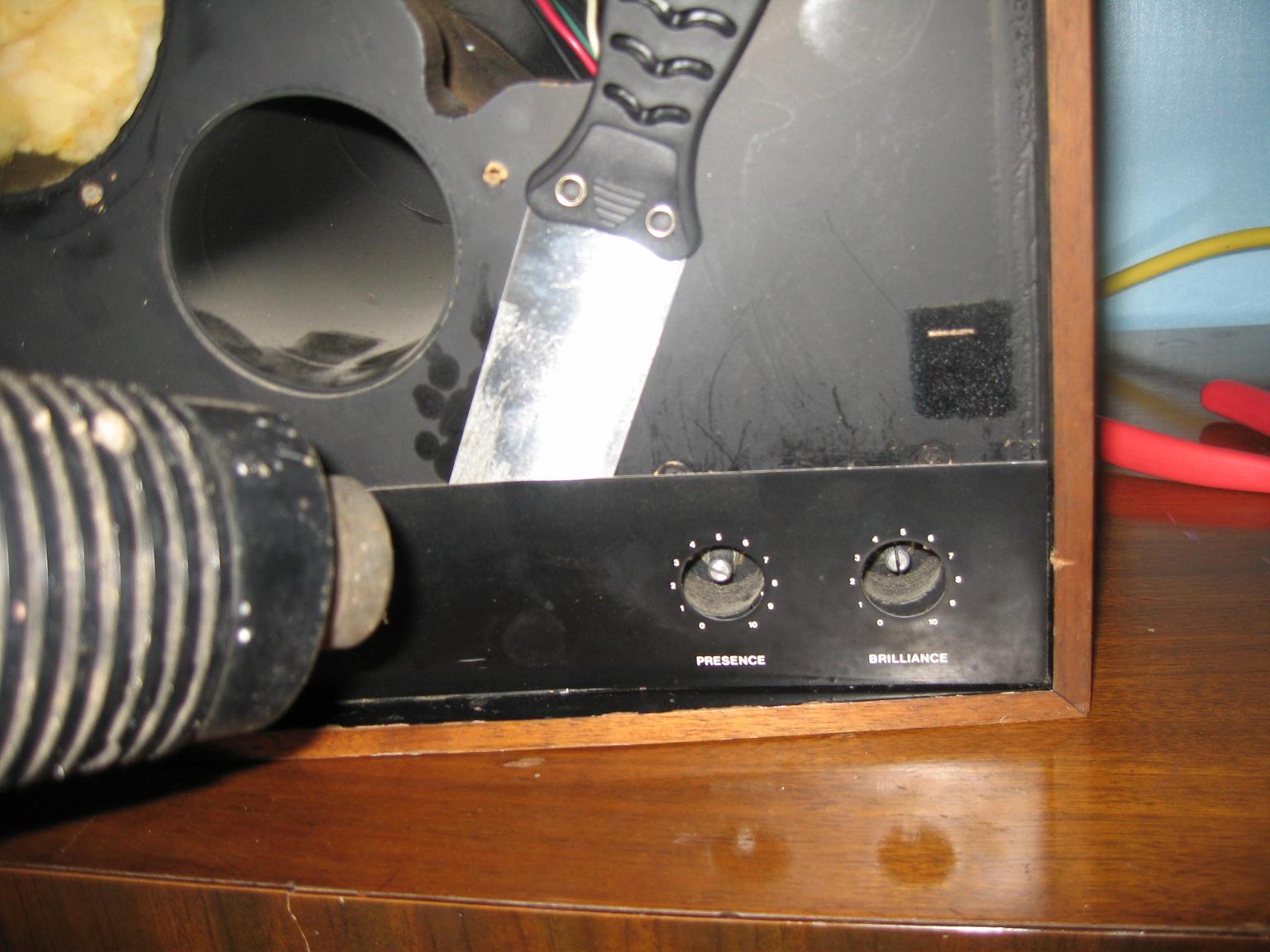

This is the technique used to remove the foilcals from a JBL 4311, to gain access to the screws that hold the crossover network in place. Tools used were a heat gun and a full flex putty knife.
