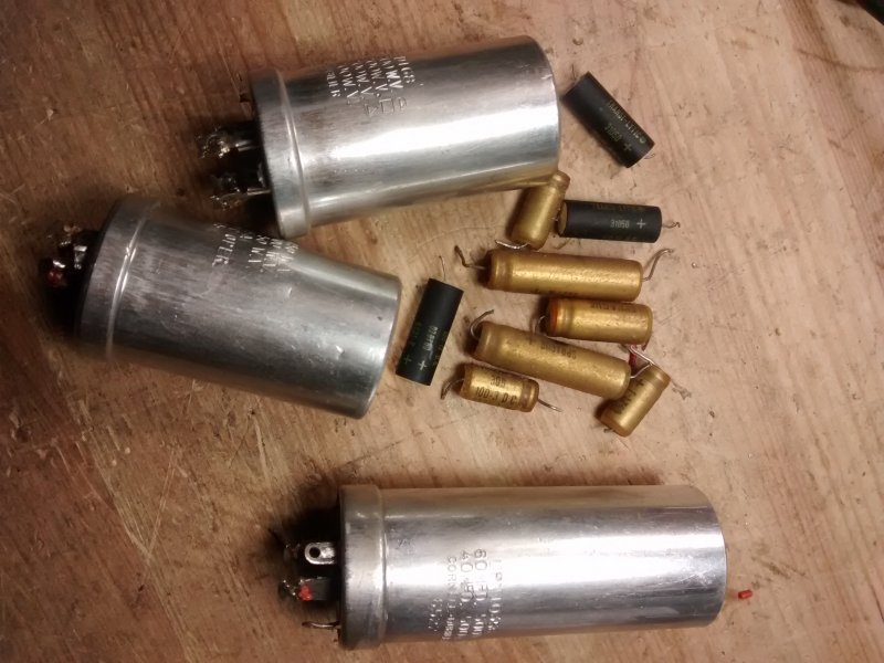

Mac 1500 Electrolytic Capacitors Replaced
See the minor bulge in all 3 of the Can Capacitors? Not looking good,
The bulge you are seeing is a mechanical deformation caused by the letter stamping process. Some caps have it,some have it worse than others,and some don't have it at all.
