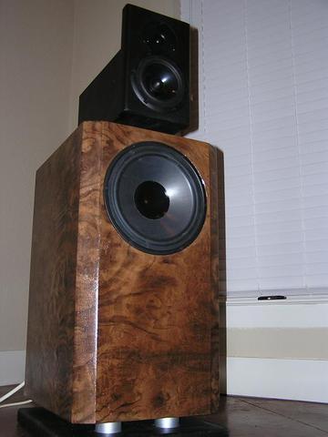

Here is a 3-way design that retains the focused sound of the MB0W1 above 500 Hz, but provides notably cleaner midbass production and, of course, deeper bass capability. The 3-way adds the Peerless 850146 CSC-X Line 10" woofer ($64 each at Madisound) in a two Cubic Ft. sealed box that can serve as a stand for an existing MB0W1. The bass-mid crossover is 350 Hz using a second order acoustic slope.
