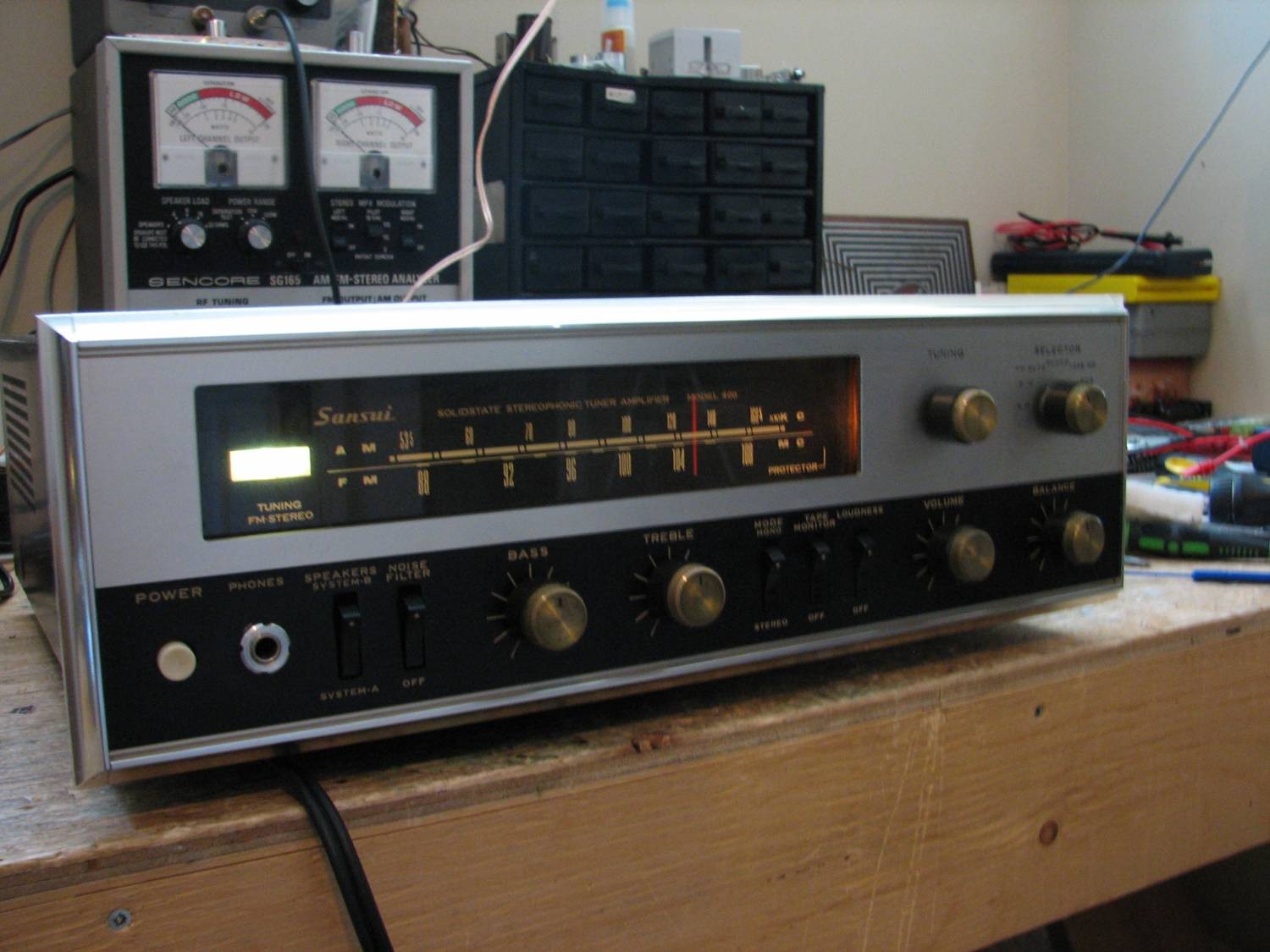

Pic after repair- recapped the amp and pre amp boards, replaced the coupling caps, mpx bulb and dial lamps- 1 resistor on the input selector causing channel imbalance, 1 bias transistor on the amp board- set idle to 20ma on both channels.
