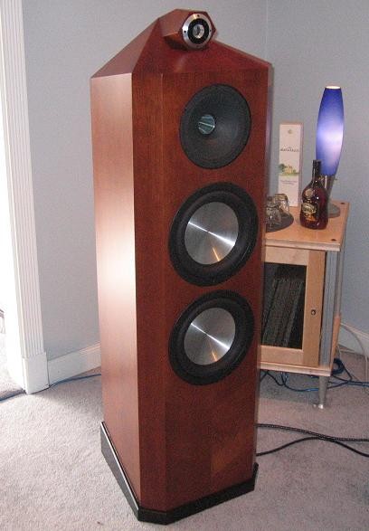

Project I designed about 5 years ago. Uses coax 8" (Radian-based), flanked by LCY ribbon supertweeter, and dual TC Sounds 10" woofers assisted by triple TC Sounds 10" passive radiators (on rear of cabinet). Bass is self-amplified by 500w amp mounted in bottom of enclosure. Response flat from 16-47000 Hz (-3dB). 95dB sensitivity on main section (concentric/ribbon), very flat 8 ohm load. Cabinet designed by me, with one pair built.

Looks like another speaker someone built about eight hundred and one of... awesome work, can only imagine the pleasure if they sound half as good as they appear!
