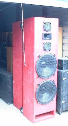

Custom PA/theater speaker systems built for Anime Weekend Atlanta. Six feet tall! Dual 18" Tonegan woofers, dual Eminence Alpha 6 mids, Eminence APT150 tweeter. Flat from 30-19000 Hz (f3). 101dB sensitivity! Used as part of giant music video theater exhibition system, along with four 18" bandpass subwoofers, and two double-15" rear-fill/delay cabinets, and about 4KW of amp power. Easily provides sound for 1000-person ballroom!
