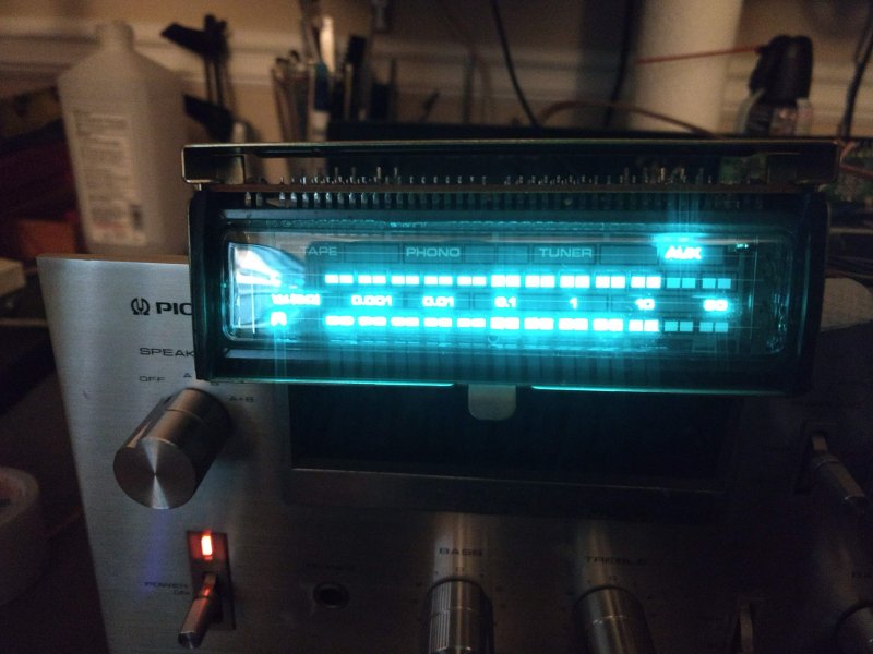

This is the SA-880 VFD with localized brightness dimming right to left due to phosphor deterioration. This is enhanced supply voltage with the 20V zener. Although the phosphor attenuation is still present the whole display is significantly brighter. Perhaps 70-75% of original.
