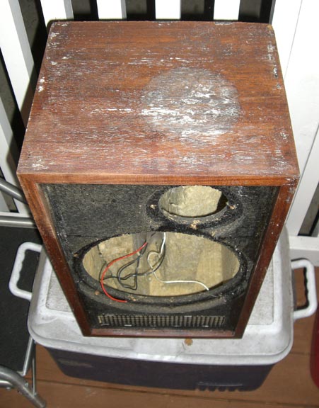

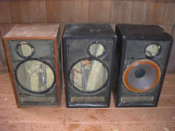

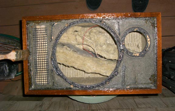

Picked up 3 free mostly driverless Dynaco A25s a couple weeks ago. I've sourced original woofers... probably get the Seas replacement tweeters from Madisound. Caps are on the way from PE. Two of these will be fixed up, paired with a ST35 and given to my wife for Valentines Day.
As you can clearly see, my work is cut out for me. After a quick call to my dad I picked up some environmentally friendly orange-based stripper and got to work. Everything went so well that I forgot to take pictures. Check out that beautiful walnut veneer that used to be painted black!
Here's a view of the less damaged cabinet

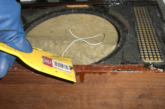

Alright, so I'm back on track here applying the stripper to edge so you can see how easy it is to remove.
The paint is coming off like a knife scraping butter from toast. Nasty dirty butter. As soon as this stripping process is complete, then I break out the #3 or #4 steel wool and get to sanding.
So yeah, my work is cut out for me. This houseplant induced water stain is probably the reason why the previous owner painted these puppies black in the first place. Well that and a lack of good aesthetic judgment. Wish me luck. I have many hours of sanding ahead of me. If you have any speaker rehab advice, let 'er rip!

You have the uncommon advantage of making a mirrored pair there. I can't recall which was the lower production numbers, but one of those, with the tweeter located differently than the other, is an uncommon one.
I too, have three orphans, and one of them is the uncommon mirrored as well.
We should keep in touch, because I'm restoring mine, and have a lead on original parts- possibly more than I'll need. Maybe I can help you out with your resto.
Paul
You'll be glad to know that the walnut veneer is pretty thick. I bought a pair in a garage sale a few years back and both speakers were badly scratched. Some so deep that I thought for sure I'd go through the veneer. As luck would have it, I was able to sand out all of the scratches. I then applied a walnut stain and finished with a couple of coats of satin polyurethane. Turned out great. Good luck with yours.

I must have your missing orphan. I have one of those someone also felt the need to paint black. looked for its mate for a month then threw it in the orphan pile.
Whoa cool, I can't believe I didn't notice I had a mirrored pair! I guess I was just so hyped to get cracking on this project.
Cap values can change within the run- the miss-matched (but then that's a bonus- you've got mirrored!) cabs I've run across have different cap values in the crossover. So be sure to make sure with these you get the crossovers to match correctly.

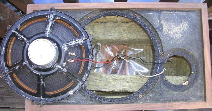

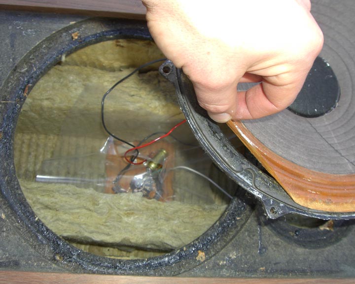

Now's my chance to label these wires so I can properly hook up the new drivers.
Check out this re-coned 25 TV-EW Woofer! The paper surround just peels away. Maybe I'll learn to refoam on this backup driver. Any idea where I can get a replacement rubber surround?

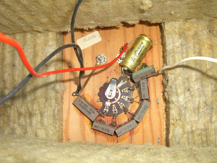

And now we get to the heart of the matter. The crossover. I wonder if that Jensen cap is still good? No matter, I have replacement Solens to install.
Well what do you think, should I install all new resistors while I'm here?
I would just meter each one and see how close to tolerance they are. Mine were all within 2 to 5% so I didn't mess with them. I only dropped on a new cap in each speaker and changed the wire to new 16ga. I just had tons of extra wire...it was something to do.
Excellent choice for a rehab. I love the A25 to an irrational extent. Keep the R's and toss the C in the crossovers. A decent quality film cap is all you need there. Nothing exotic.
