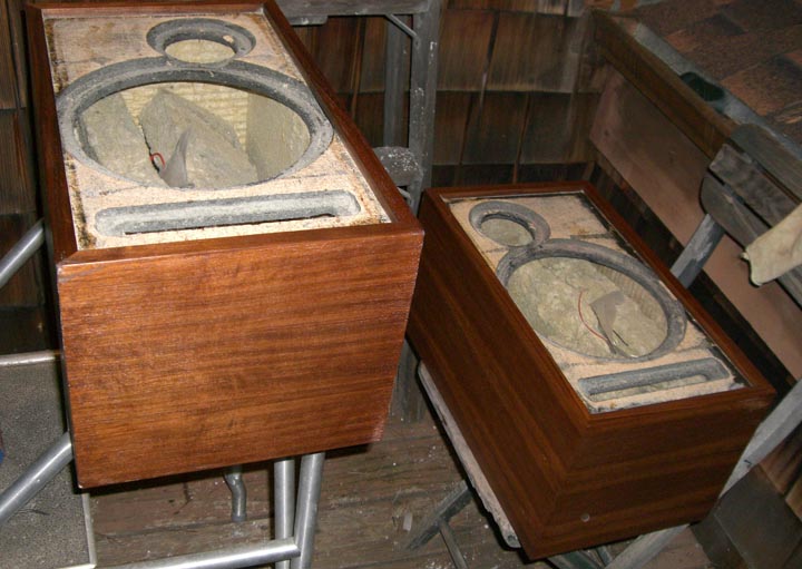

My wife has always had sub-Yorx BPC so it's pretty important that I deliver the goods. With the deadline looming I plunged full steam ahead last night, stopping by my 24 hour Longs Drugs on the way home from work and grabbed some matte black latex paint and some oil. I had been planning to use tung oil but unfortunately Longs doesn't stock tung (they have a wide assortment of woodworking oils and products) so I grabbed the oil with the least ingredients; some non-toxic orange and beeswax oil and went to work. It smells great! :drool:
The thirsty speakers guzzled oil like a long distance runner. So thirsty in fact, they easily absorbed moisture from finger tips and from a fallen leaf that I had accidentally placed them on. It actually left a stain that I had to sand out.
After the first oil wash it became apparent that I had missed a few spots of embedded black paint and primer that was lodged deep within the wood grain. I used a dentist's pick and a swiss army knife to dig out the cavities followed up with quick massage with some #0000 steel wool. Fortunately the walnut veneer on these speakers is quite forgiving. The oil finish only benefited from the scrub which tells me that I will have to do multiple passes of oil followed by successive steel wool scrubbing. The worst damage, other than the plant stain, can be seen in the dinged upper left corner of the speaker on the left. Adjacent to that ding is a hole on the other side that I tried repairing with a "walnut" colored fill. I know it sucks but it will provide structural integrity while I source a triangular piece to patch the veneer. I might try fixing up a batch of fill myself from sanding some walnut and saving the dust. I just don't have time for that, I gotta get these done!

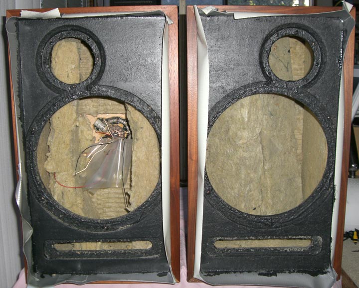

Now for the black paint. I applied the oil first to act as a resist, hopefully blocking accidental drips onto the veneer, which with careful brushwork and masking I managed to avoid. I think I need to do a second pass of black. Better safe that sorry.
The flash is misleading. It's not as dark as I'd hoped but it will do for a while. In natural light the black has a blue tint, so at some point in the future I might repaint the faces with blackboard slate. :thmbsp:
