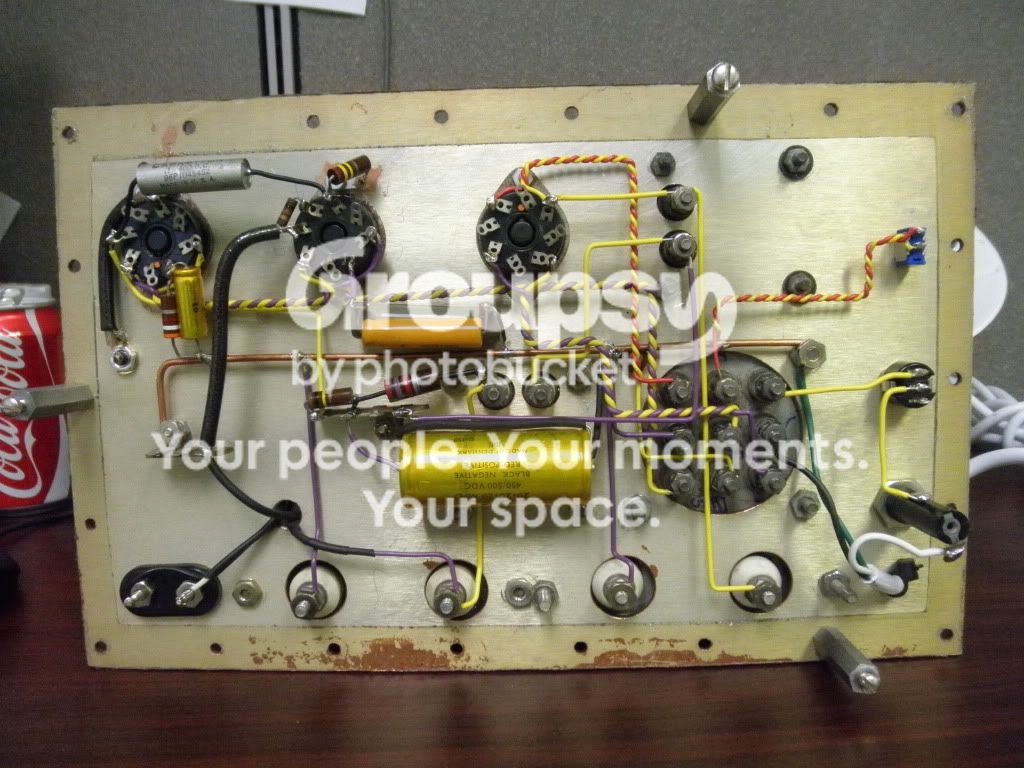

:banana:Ok its done:banana: well the first half is done anyway.. Started this a few weeks ago and just got around to finishing it up this weekend..
One more to go and ill have stereo...
Let me know what you think...

Thanks for the comments...
That wiring came out nicer than expected.. Very time consuming making it look that clean..
Jason
The circuit is a modded boozehound labs..
Its a 6j5 driving a triode strapped 6v6 SE.... 5v4g rec.. dead silent circuit

What does the little blue switch(?) do that's in the upper right corner of the underside shot?
Very nice wiring job. Meticulous.
Interesting because there is really not much to it, or just because it is that clean it looks empty...
Your wiring is outstanding!!

I use a drill and do about 8 feet at a time.. I put one end in a vice and keep it pulled very tight while twisting it..
