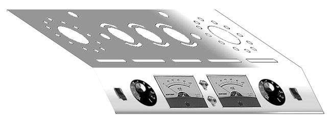

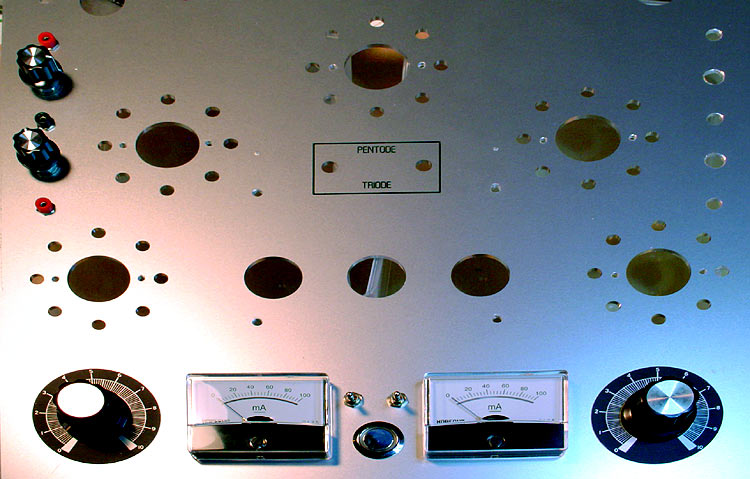

Scratched out some preliminary drawings and some kind folk pointed me towards Front Panel Express. They have FREE software for design and get rave reviews for the quality of their work. You design it, send them the output file (knowing immediately exactly the cost), they run the CNC work and ship it back. I doodled around some and came up with this ...
That accounts for all the holes that will have exposed edges. I figured to do all the holes for mounting hardware and such myself. Keeps the cost down some and gives me a fudge factor as I can match those exactly piece by piece during the actual build. The front section of the panel will be bent for the controls and meters. More on that later, but here's an early concept drawing.
Very early ... not much resemblance to what I actually ended up with. Ain't that always the way? The panel will drop into a wood base. Designed but not yet built while I check out wood options. That will also have a separate aluminum panel inset into the back for all the connections, including the input RCAs which are moved from the standard front location. Probably just go with good old oak as that's easy to machine and easily available. Only concern there is resonance as that's a hard wood and I expect could pick up a lot of vibration which can be a concern with amps.

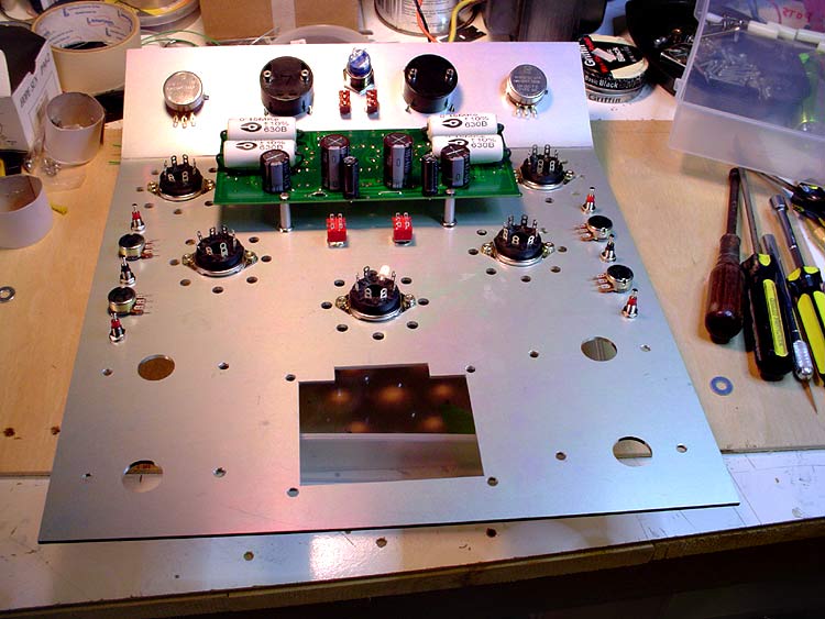

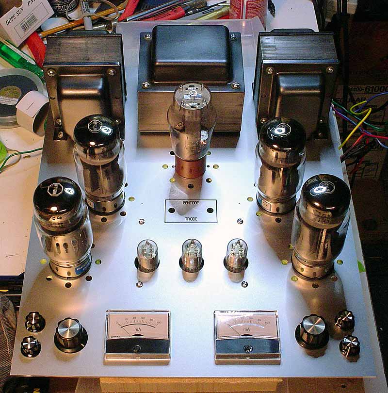

OK then ... got the panel back a week later, drilled all the mounting holes (well, most of them anyway) and here's the first dry fit from the top.
Quite happy with it ... definitely different. One of my major concerns was adding space between the bottles, and that worked out right nice. There's even plenty of breathing room between the big bottle rectifier and the transformer.
Excuse the wandering knobs ... the small ones next to the driver tubes in this pic are for the bias pots. Once I got the tubes in, I can see where that would have made for a lot of tender fingers. Just as well to put them on the front panel. Only change there is now the power switch and light will move to the wood front of the chassis. There will also be a couple mini-switches between the meters so I can switch from front to back on each bank when reading or adjusting bias.

VTA Driver Board
As said, the original design had this hanging out the top. My chassis plate was designed to recess the driver board with only the glass of the tubes showing. That required relocating the big caps (C13-C16) to the bottom of the board. That done, the tallest part of the board is the sockets themselves. Here's the finished product ...
One nice feature of the board is that both sides have solder tabs so you can flow thru the board and get real solid contact. This was a BIG advantage with swapping the caps to the other side. I just put a temporary riser under each so I got a bit of air space and could also inspect the joints for good flow both sides. Here's what it looks like from the bottom ...
I also had some fun with the PIO coupling caps, adding a heatshrink cover and custom printed labels to pretty them up. There's always a chance of shorting the standard bare metal cases to ground or worse, so there's actually a practical side to the mod.
Unfortunately, I already had the board built before I decided to replace the original board mount bias adjusters with standard pots. I'll have to pop those pretty PIO's to remove those and add twisted wire long enough to reach the new pots on the front panel. Not a perfect world, and I'm here to keep it that way! <G>
Speaking of not perfect. Somehow or other I missed the target when drilling the mounting holes for the VTA driver board. That put the glass envelopes right up against the back of the holes in the chassis plate. dOH! Easy fix though ... The board is mounted about an inch below the chassis plate and I was able to bend the bolts just a bit to center the tubes. Shhhh ... I won't tell anybody if you don't ...

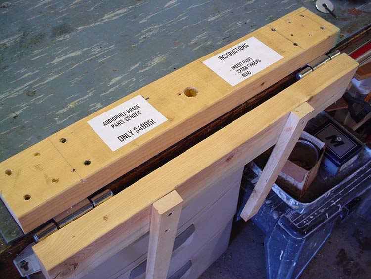

Had a few folk tell me I'm gonna end up with stretch marks in the metal or kinks at the bend, but it's no gonna be all that tight or radical. We're only talking about 30 degrees at the most with no sharp corner. I did some research and there's quite a few DIY metal brake designs that should do the job nicely. Something like this ...
The panel is only 13" wide, so the hinges will be close enough to keep the wood of the brake from flexing any. I figure to add some air space between the hinged parts and round over the piece that the metal will be bending over. That should make for a nice rolled transition. Screw the panel down tight to the bottom of the brake so it doesn't shift. Keeping my fingers crossed that it'll bend clean, but if for whatever reason I do mar the metal, hey ... nice place for a pinstripe or two, right? <G>

Final Control Layout
Last version looked too busy, so I did a bit more shuffling ...
Seeing as how the holes are drilled, I think I'll stick with it. <G>
The Mallory vernier dials for the volume pots were a junk find. Was digging around for something else, and they popped out. I do like that annular power control in the middle too.
I also went back to having the bias controls at the sides. Plenty of room to get my fingers in there on a hot set without leaving patch marks on the tubes. Also good clearance on the VOM probes when inserted in the test points. One other thing I got to do is cut down the control shafts so the knobs flush out with the top of the chassis plate. Easy enough with a cutoff wheel as long as I'm careful not to heat the metal.

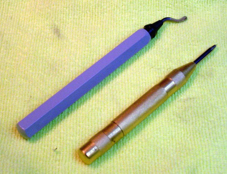

Couple tools I have now designated as "indispensable" for this sort of thing.
The gold thingie is a spring loaded metal punch. Just locate the tip where you want to drill a hole and press down. The internal spring drives the tip into the metal making it easy to locate the bit. Eliminates any walking ... I hate that when that happens.
The blue thingie is a deburring tool. Rather clever little device. The blade swivels in the handle - just insert it into the hole and walk it around the edges to clean them up. The blade automatically stays square to the edge. Depending on how hard and long you work it, you can even put a miter on the edges. Makes short work of aluminum, but it's actually supposed to be made for steel.

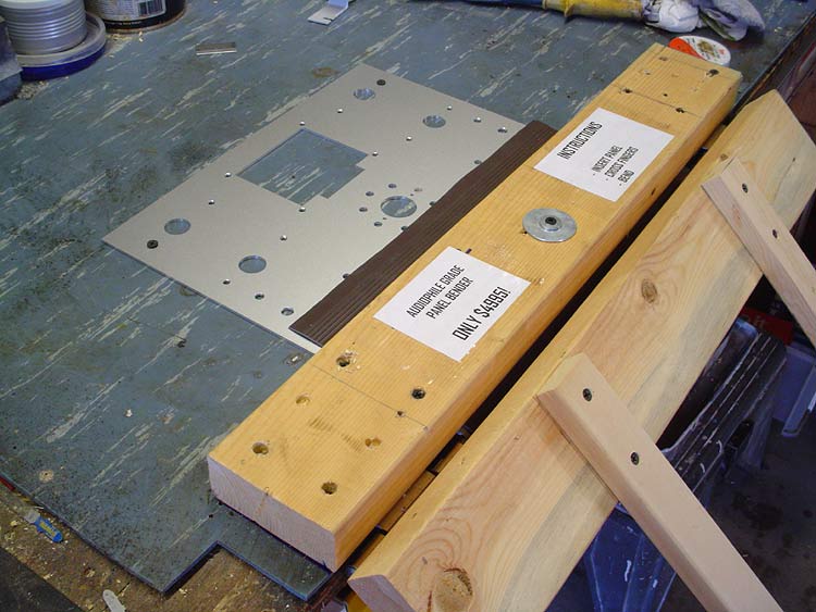

Next step is to put in the bend for the front panel. Fingers crossed ...

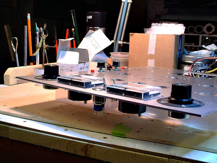

Will the bias meters sit flush with the metal cabinet?
What you see is what I'll get ... the meters do sit around ¼ inch proud of the chassis plate by design. I did have the option of back mounting them, but I think this is a cleaner look and a whole lot easier too. If nothing else, it adds some interesting shadow lines for effect.
I plan to use some 3M body molding tape around the edges to seat the meters and eliminate any chance of vibration. Pic also does a nice job of illustrating why I want to cut down the shafts on the bias pots ... dremel tool will make short work of that.

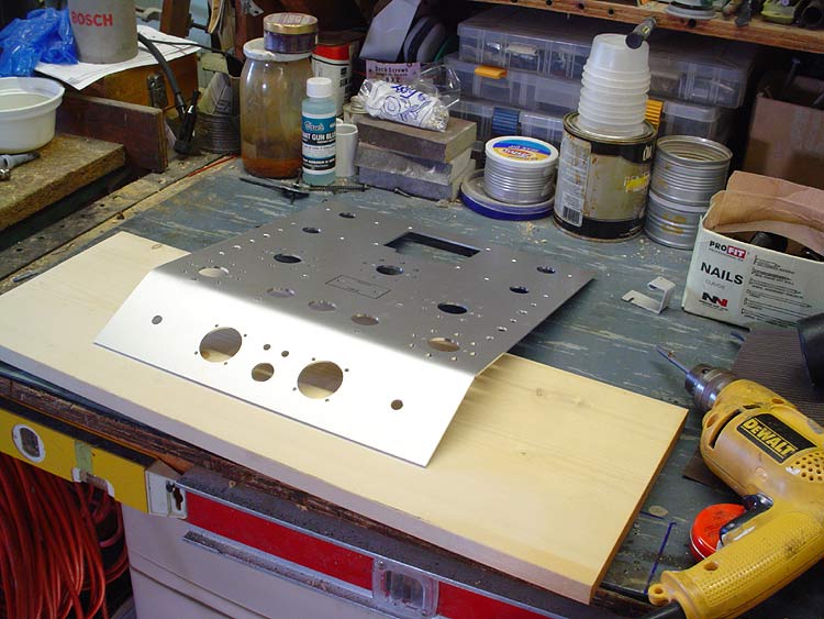

Got the bending brake made ...
Here's the panel jigged up and already bent.
I screwed it down to the bench in a couple places to keep it from walking, and also added a bolt down the center of the brake thru one of the driver tube holes to keep it firm. Metal bent a lot harder than I expected, but ...
Like I said, not much of a bend. Here it is after a final fit.
... and from the bottom.
I did rework the mounting system for the VTA driver board. Found some real nice threaded spacers and used crown washers on both sides of the plate for a good grip. I also enlarged the holes so I could slide the board around a bit to center the tubes in the holes. Works a whole lot better now.
