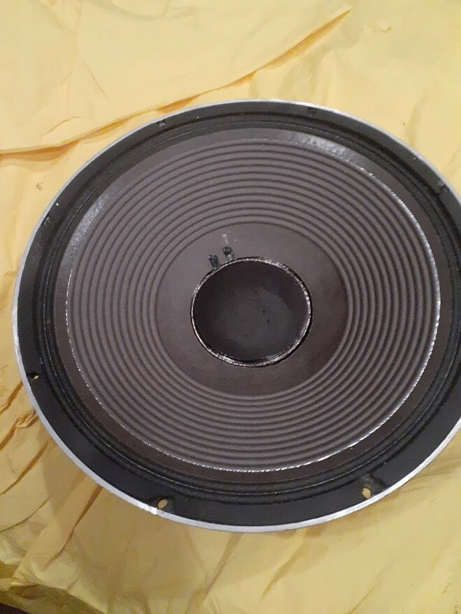

This is how an incorrectly installed surround looks on a 2235H (note that this is not the correct single-roll foam also), image copied from ebay:

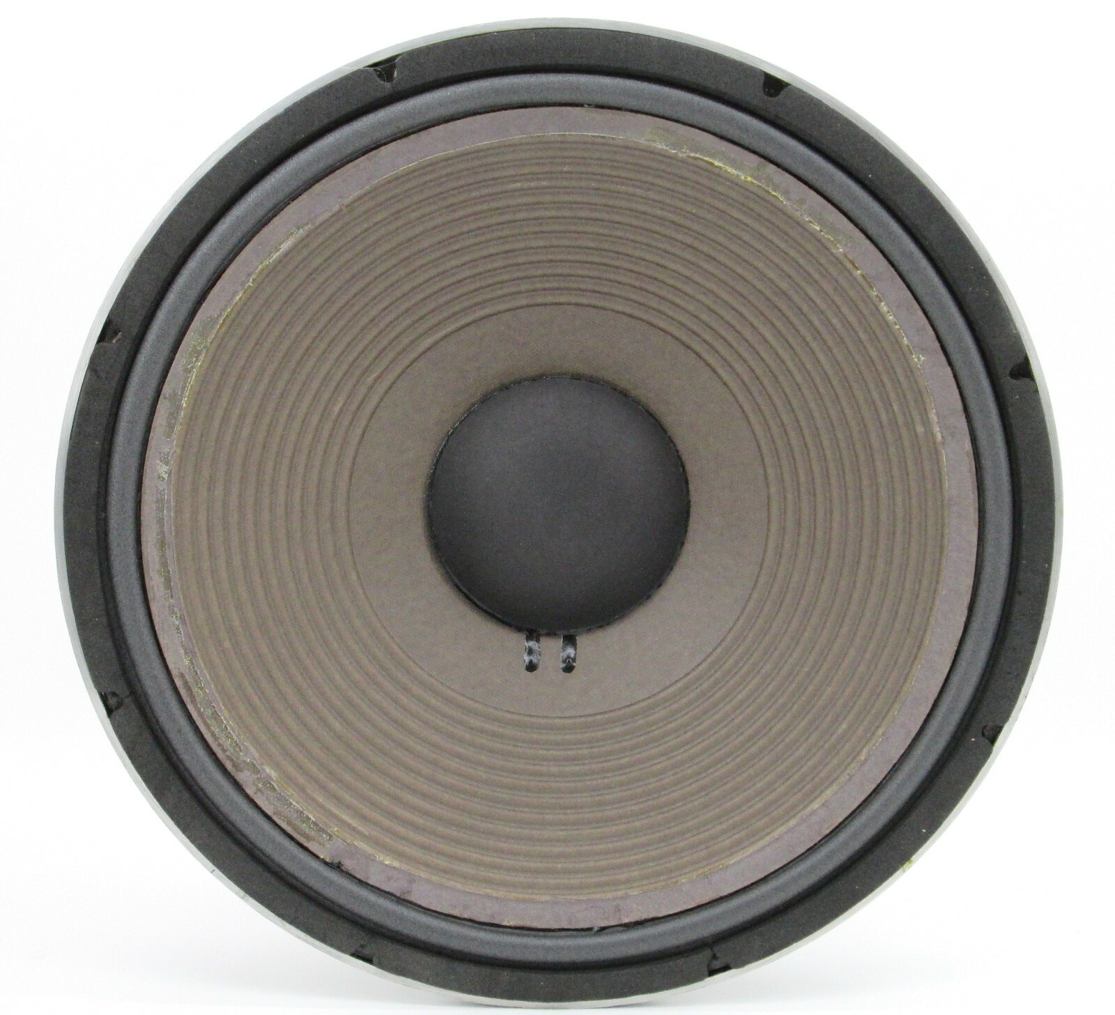

Probably this is the best that one can do removing the front-glued surround (image also copied from ebay):
Really almost a best-case scenario (image copied from ebay):
The prosepect of re-foaming on the face of the cone and shimming the foam out (thickness of foam plus thickness of cone edge) does seem like it would work however, you're proposing removing the foam from the front of the cone to replace it and make this change, in which case I'd be inclined to just refoam on the correct side and leave the above evidence, or if the foam is deteriorated enough just rub until as much foam is removed as possible and leave the rest of it alone.
Re-foaming isn't an exact science unfortunately, and when new cone kits are still available from the manufacturer it seems better to simply re-cone. There's no way that you can remove all of the foam and glue from the back of the original cone and maintain the exact same mass, and all of the handling necessary to even come close is likely to fissure the aquaplas on the cone which is also not good, if the cones aren't available of course refoam makes sense. If I had an alnico woofer that needed foam and the original kit were available however, I'd send the thing out to be re-magnetized anyway, might as well have an original performing woofer if you can.
