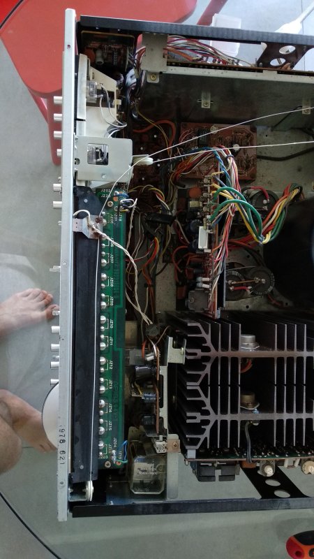

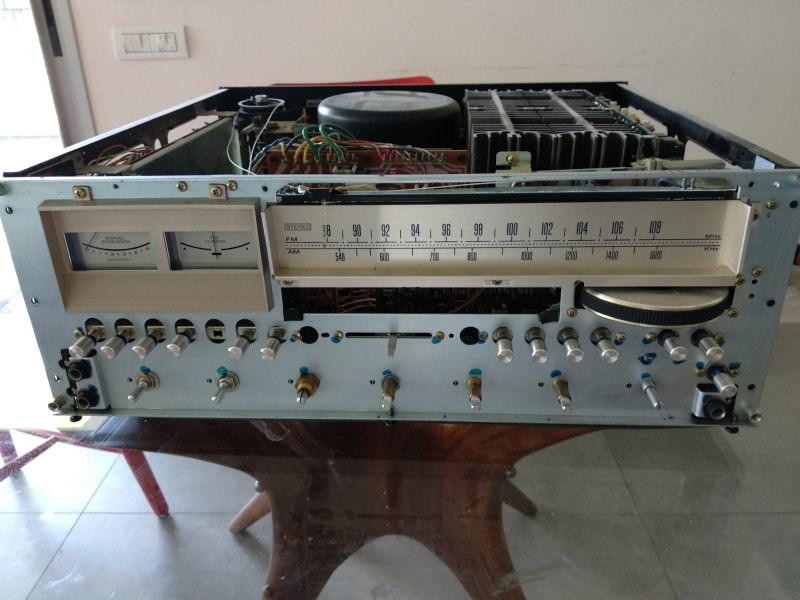

The problem gor worst. sometims I am losing the right channel so I Finally managed to find time for it. I am stuck with the disassembly..
On the right side, something is preventing me from pulling the front panel out. what can it be? what am I doing wrong?
If you are wanting access to the volume pot then you have much more disassembly to do! Look at my photo in this thread, all of the front panel attachments must be released to open up the tone/preamp board where the volume pot is mounted. That means removing the dial plate, pointer, complete tuning string and pulleys, gyrotouch wheel etc. The lamp assembly must be released from the front along with the meters. ALL of the front plate attachments are then released meaning all jack nuts (stereophones, dubbing etc), button switch screws, power switch screws etc. ALL of the control nuts must be released. Every screw on the front is removed even the balance control screws. The bottom panel has to be removed completely. On the right side of the front you still have the screws in place that hold the right side string pulley plate, those come out. You need to photo and diagram for yourself all of these areas so you can reassemble properly. It is a lot of work but if you go slowly and carefully it will be ok. In the service manual it shows the dial string, pulley and wheel setup which will help with reassembly. The service manual is free online (https://www.hifiengine.com/manual_library/marantz/2385.shtml) free membership. Search on eBay for Marantz 2385 there are tone/preamp boards some with volume pots some without. Good luck with your project!

The layout of the 2385 looks very similar to the 2500. On my 2500 I was able to remove the preamp board containing the
volume control from below. Flip the receiver up on end , remove the various screws and retaining nuts from the pots, and
carefully maneuver the board out.

The PT top board has three multi pin plugs that connect to the lower preamp board.
The left side PU board has a similar arrangement with connecting to the lower P400 selector switch board.If you messed with the left side boards there are even more(at least a dozen) connectors that can easily be incorrectly hooked back up.
I thought I read that you pulled out the preamp board to access the 4 gang volume control.
Major pain to make sure they all line up...
Bob
