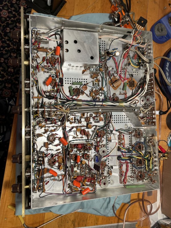

So i picked up this 100% original 500B, and it was working. I performed a brief basic function test before I reworked it with the metalbone kit. Now it no longer has power. The rear AC outlets work, so the power switch and fuse are fine, but the rest of it I'm not so sure about. I quadruple checked all of my work, and everything looked fine. The only thing i saw was C85 MAY have been shorted. The pins were uncomfortably close, but I'm not sure whether it was or not.
Does this sound like something you've ever experienced? I suck at troubleshooting so please be gentle :(
Note: In the photo below, I undid the bias caps mod as a sanity check to make sure that that wasn't the problem. It didn't change anything.
Edit: Here's a less compressed version of the image on imgur: https://imgur.com/a/ptY4cxZ
I see a new bridge rectifier, new silicon diodes, new Sonic coupling caps, orange-drop coupling caps and a modern electrolytic or two. So what else did you replace?

I've been using a Kill-A-Watt to watch for anything. 0 Watts/0 Amps. The fuse is good, and the power switch is good. I replaced C85 (near the PSU section), C74 (towards the front, near the MPX section), and C210(In the MPX section) with new electrolytics. C57, C58, C60, C61 were replaced with sonicaps, and the rest of the mylar caps were replaced with orange drops. I also added 10 Ohm resistors to the output tubes from pin 5 to ground to act as fuses if there were a short. That's it, all pretty standard stuff as far as I can tell.
When I powered it up after the work, no light in any tubes. Zero signs of life. No power draw, no heat, nothing.
Do the tube heater filaments get any voltage? I see that you cannot observe the filaments getting hot, but what about a voltage measurement?
If you're getting no current when powering up, then something very early in the chain is not working. I haven't looked back over the thread so forgive if you've already checked. Are you getting any voltage at the rectifier or at the filter caps? Any negative voltage coming out of the rectifier?
0 Volts between pins 2 and 7 of the output tubes. Also 0 between pins 4 and 5 on the phono preamp tubes and tone control amps tubes, V7 through V10
0 volts between the + and - pins, going both ways. I agree that it's something early, I just don't know what it could be. Almost seems like the transformer, but I'm not really sure.

Ok, so I took some measurements. I have some functional knowledge of transformers (thanks college). These sort of make sense, other than being lower than I anticipated. I measured after de-soldering each lead. I didn't measure between leads, it didn't occur to me at the time.
Orange+Brown 1.9 ohms
White + Blue 0.7 ohms
Green + Yellow 0.7 ohms
Red/Yellow + Red 4.7 ohms
Black + Black = 1.8 ohms

In your first post you say that the AC outlets still work. The main power switch is DPDT with one pole powering the outlets and the other powering the amp itself. Sounds like the amp pole may be broken. You may need a new on-off switch.
Most people don't use the outlets on the back. If it turns out to be the switch you could just use the other half by re-wiring the switch.
Right you are Tim, but if one side of that switch has failed the other may follow soon.
Ding ding ding! We have a winner! I checked for continuity and sure enough, only the outlets were going through. I never would have noticed that it was a dual pole switch if you hadn't mentioned it, thank you so much!
I switched the wires around and sure enough, fired right up. I didn't do a full test because I'm tired, but at the very least I am a lot closer.
Thank you so much guys! You've been a great help, I literally couldn't have done it without your help.
