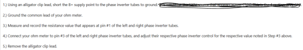

Is this how I adjust the PI in a 500C -
1.) Ground the common lead of your ohm meter.
2.) Measure and record the resistance value that appears at pin #1 of the left and right phase inverter tubes.
3.) Connect your ohm meter to pin #3 of the left and right phase inverter tubes, and adjust their respective phase inverter control for the respective value noted in Step #2 above.
4.) Remove the alligator clip lead.

NEW AND IMPROVED way, and the way I did it. This involves no desoldering, soldering, or math. Just a DMM and a Jumper wire with 2 alligator clips. AGAIN! TURNED OFF AND UNPLUGGED!!!!
NOTE: PART #'s change due to SERIAL #'s.
For those having units with serials of 29999 and below, the relevent part #'s the B+ to Ground is C75C.
For those having units with Serials 48001 and above, the relevent part # of the B+ to Ground is C52C.
It's the SAME PART Just uses different part # on the schematics.
1.) Using an alligator clip lead, short the B+ supply point to the phase inverter tubes to ground. This would be the 320V source that appears across C52C. This is the 4 section CAN CAP.
2.) Ground the common lead of your ohm meter.
3.) Measure and record the resistance value that appears at pin #1 of the left and right phase inverter tubes.
4.) Connect your ohm meter to pin #3 of the left and right phase inverter tubes, and adjust their respective phase inverter control for the respective value noted in Step #3 above.
5.) Remove the alligator clip lead.
Close it up and enjoy.

Ground C91C(350V B+) and follow directions outlined in POST #1
I adjust with a 1khz sine wave when driven just into clipping. Adjust for even clipping top and bottom of the waveform.
Using an appropriate load resistor of course.
500-C 30001-49999 manual
I don't know how to ground C91C. I assume that's the 2 wires attached to a resistor coming off the PI. Do I just alligator clip a wire from them to the
chassis? I'm OK removing individual resistors a la the 1st option (this post #2), but don't think the right resistors are listed above for a 500C.
Wired alligator clip to C91C lug with other end to chassis. That will ground your B+ to chassis.
Now follow instructions:
