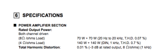

Hello guys. I want to buy wharfedale linton heritage and i see they are rated at 6ohm. My amplifier is the denon pma 1500r and i am not planning to change it anytime soon. Amp is rated 70watt at 8ohm. It has A+B speakers option at 8~16 ohms and A or B speakers option at 4~16 ohms. Will there be problems if i run the speakers with A or B option? Any chance to harm the speakers or the amplifier? Should i seek an 8ohm speaker? Thank you

A or B, "or" being the operative word which means you can run a pair of 4 or 6 or 8 or 16ohm speakers
However if you run 2 pair of speakers at the same time (A+B) each pair would need to be a minimum of 8ohm
This is from the Denon OEM user manual for your amp
