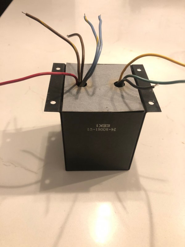

I am posting this in the hopes someone can shed some light on some nice old iron I just acquired. I have two nice PTs and two nice ultralinear OPTs, all pulled from two mono 6BQ5 ∕ 7189 amps. These were taken from organs from the early sixties. The amps have 6GH8s and EL84s in push-pull. I removed the transformers today and the center-tapped PT produces 510V on each of the red wires relative to the centre tap with 124 VAC applied to the two black primary wires. My plan is to build a pair of monoblocks based on the Sherwood S-5000 schematic with this iron.
I do not have a schematic of the donor amps but I do have a similar schematic from the same era, by the same manufacturer (Electrohome). That schematic shows 4, 8, and 16 Ohm secondary taps on the OPTs. As you can see from the photo posted, there are only three secondary wires. So to develop the circuit, I need to figure out what these taps are because the circuit I hope to use takes NFB from the 16 Ohm tap. I am not even sure I have that tap.
So I connected a variac to the OPT primaries (blue and brown) and determined the turns ratio which is 29. The possible reflected impedances correponding to 4, 8, and 16 Ohms are 3364, 6728, 13456 Ohm, respectively. Looking at the 7189 and EL84 datasheets, under pentode connected UL operation I read 11 kOhms, plate to plate. To be precise, I was applying 29 VAC to the secondary plate supply wires (blue and brown), whilst measuring 1 VAC between the green and black secondary. At the same time, black and yellow gave 0.71 V and green to yellow gave 0.29 V. The DC resistances I measured on the secondaries were 1.9 Ohms (black to green) and 1.5 Ohms (black to yellow).
Can I conclude from this that since 13456 is closer to 11000 than 6728, that the secondary tap with the largest impedance is a 16 Ohm tap (black to green) and that the other tap (black to yellow) would be an 8 Ohm tap? From looking around on the net it seems rare those old transformers had just three secondary wires. Would it be more common to see 16 and 8 than 8 and 4 in such a case?

choke: 24-110021-01 EEK1
OPT: 24-80061-01 EEK1
PT: 24-10077-01 EEK1
Take a look, see what you think...

Pending review of my math by those more knowledgeable, it seems to me that you have a 4 and an 8 ohm winding on the secondary. 29/.71 give you a turns ratio of about 40.85. Square that and we get an impedance ratio of 1668. 1668x4 gives us just about 6.7k ohms so very close to the 8 ohm claculation.
I'd have to do some digging to verify but I'd be willing to bet that the original Sherwood transformers that the schematic you want to use is based on, were much closer to 6.7K impedance than to 13K.

You should also validate that the leads you've selected on the primary are in fact the plate leads. You can validate the primary lead orientation by driving the transformer backwards. Put say 5VAC between the yellow and black leads. That should put about 145V AC on the primary between the leads you expect are the plate leads. But then, while keeping one volt meter probe fixed on its primary lead, move the other volt meter probe to the other available primary leads and see what you measure. If you have the plate leads properly identified, you will measure less voltage than 145V on every other available primary lead. You can also use this technique to identify which screen tap lead pairs with which plate lead. You should not assume the lead color gives you this information.
Assuming you've got the primary plate leads correctly identified, the other issue to consider is perhaps the manufacturer spec'd the output transformers for an odd secondary impedance. For example 10 and 5 ohms instead of 8 and 4 ohms. So if the yellow tap represents 10 ohms, it would reflect 8.4K to the primary, as an example.
Because the voltage ratio between black-to-yellow and black-to-green is 0.71 (inverse of root 2), the impedance ratio between those two is 0.5. So whatever impedance exists between black and yellow, the impedance between black and green must be 0.5 of that (assuming your voltage ratio measurements are correct).

You mentioned that you got 1 Volt out at the green-black secondary winding when applying 29 Volts to the primary, that would be your 6.7K 8 ohms . You also got .71 Volts out of the yellow-black winding using the same 29 Volts at the primary. Simple math as shown above says that this would have an impedance ratio of 1668:1, so then we ask ourselves what seems more logical; that this is a 4 ohm tap at about 6.7K ohms impedance or a 16 ohm tap at 27K impedance?

Dave, thank you for your comments. Why do you (or did you) presume the OPTs are not UL devices? My reasons for assuming they were are that they were sold to me on that basis (no guarantee, admittedly) and also the schematic, and the tube wiring. But I have been poking around these forums long enough to know better than to take your comments lightly... If these are not UL then I will likely cancel the whole project!
