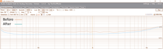

OK, some details since some of these measurements now hit the sensitivity limits of my somewhat noisy equipment. When measuring across sweeps in power or frequency, THD vs power or THD vs frequency, the measurement floor is around 0.02% THD but around 0.04% THD between 20-30 Hz due to 60 Hz noise in my measurement equipment that I couldn’t resolve. For noise testing with a static reference or test tone I can consistently measure down ~-94 db excluding 60 Hz noise. Readings will go lower, but they are not consistent. As before I’m just showing one channel, the worst of the two (right), which has about 0.01-0.02% more THD above about 6kHz. All before and after testing is shown with tone control defeated. I did plenty of testing with tone control on and off, but the results are complicated, and the differences are very minor.
The clipping and oscillation issue that was limiting power is resolved. Power output looks clean @ 1k Hz to about 85 W! A big improvement from 48. The zigzagy lines are THD.
The largest improvement to THD is at around 1 W and may be better than shown since the values are at or near my measurement floor.
At 5 W we see only a minor improvement in THD from the restoration. I believe that high frequency distortion is partially controlled by the amps slew rate. It measures at 5.7 V/us on the right and 7.0 V/us on the left. That might also explain why distortion is worse on the right channel but only at high frequencies. Although only 3 V/us is needed to produce a 20k Hz signal at the amps full output voltage, the general rule of thumb is that the slew rate should be 5 times this value (15 V/us) to minimize distortion from ringing and feedback.

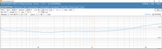

It's worth remembering that we can’t hear the harmonics of signals beyond 8K Hz (ish), so the plot below is of “audible” distortion for different frequencies across power output, including only harmonics in the 20-20K band. Notice that at 5K Hz the 2nd and 3rd harmonic are in the audible range and distortion is outside of Sansui’s spec. Maybe there is still something wrong with the amp, but it’s not extreme and may just be age on the transistors and mylar caps. Happy to hear any thoughts.

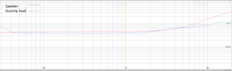

...It occurs to me that I’m doing all this testing on an 8 ohms dummy load, but speaker impedance is often much higher than 8 ohms at higher frequencies and would load the amplifier significantly less. Since the distortion is so power dependent, it makes sense that it should also be load dependent. Here I compare the THD across frequency at 20W on a speaker (blue) and the dummy (pink). The real world (ish) scenario looks much better and is near enough to factory spec.

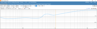

Noise is greatly improved for both line level inputs and phono inputs. The 60 Hz noise and fundamentals on the line level input measurement is from my measurement setup. On the phono stage, 60 Hz noise is real, audible, and dominant, but the measurement likely makes it look worse than it is. Sorry I can’t be more precise.
Line level input:
Phono:

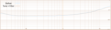

Below is a quick measurement and analysis of THD and noise of the tone/filter section of the Sansui AU 7900 after a recap but retaining all transistors in this section.

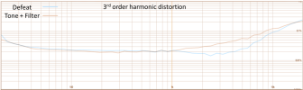

The tone/filter section reduces gain, 17.7 (tone/filt on) vs 20.4 (tone defeat) @ 5W. So, we need to compare based on the same gain, not power. Below is distortion at 25 db of gain with the tone/filter section defeated and engaged. Pretty darn close.
But more harmonic distortion is 3rd order with the tone/filter section engaged. Many people prefer 2nd order distortion to 3rd.
That said, the change from 2nd order to 3rd order distortion can move high frequency distortion out of the audible range, so audible band distortion is reduced above 6.5k Hz.
