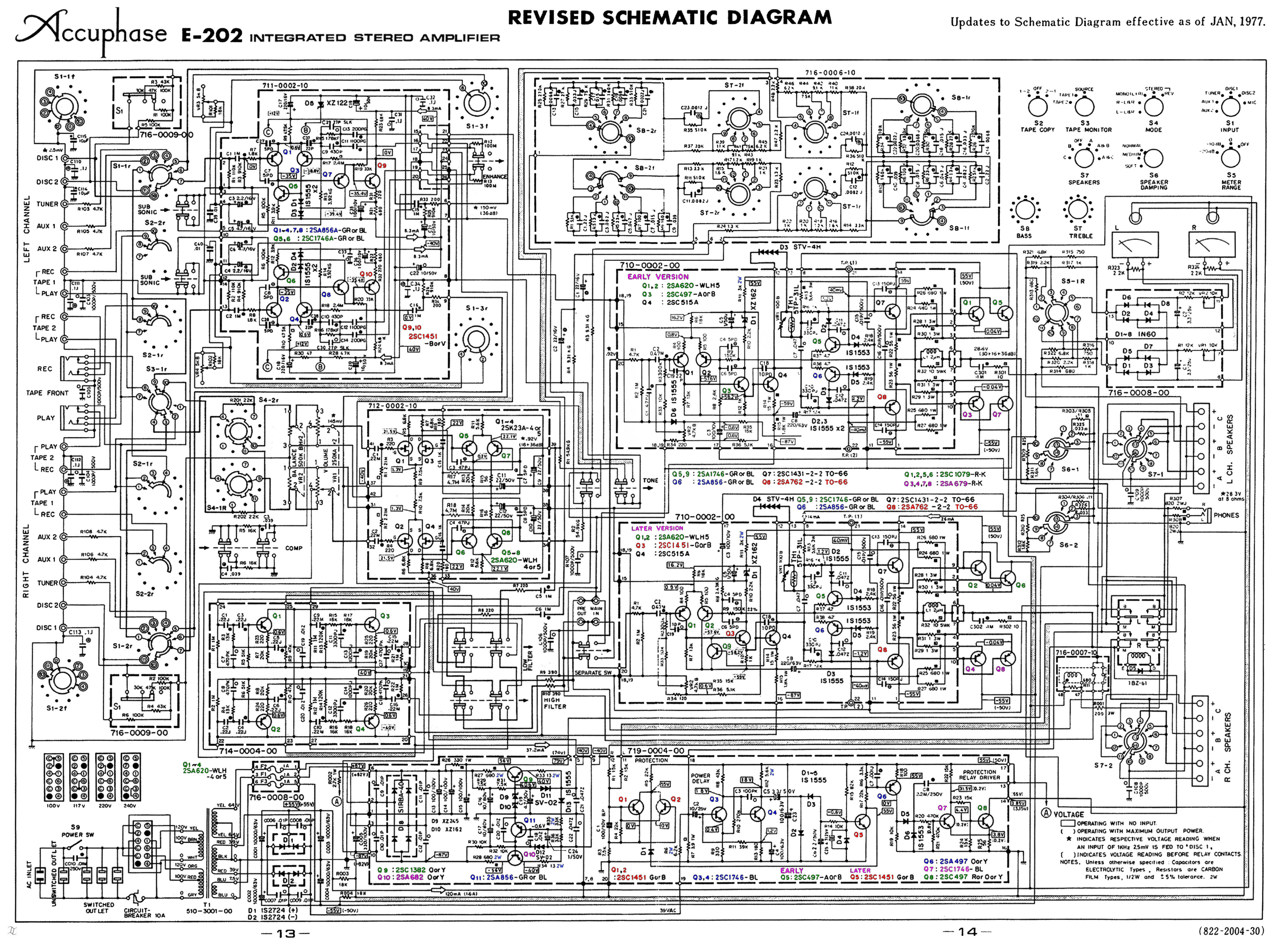

The capacitor that blew was in the place of the large one to the left . It has been swapped but the problem are still there. I finally found a better service manual on the amp than the one i had. With a circuit diagram on the amp .So hopes are getting up on getting this amp up and running again. :) so know i know what circuit the cap that blew was connected to. So im gonna trace down the connections to it tomorrow and see if i find something bad. If i remember correctly i think i did not hear any relay click after i turned the amp on either so. Alot to check tomorrow. :)

Coincidentally, I happen to be into another E-202 currently. Perhaps this will be helpful:
http://www.wwdsltd.com/files/AccuphaseE-202RevisedSchematic1977.jpg
It is apparent that the power supply is among the weak links. It may be worthwhile to remove the driver boards, tone amp board, and filter amp board. At that point it might be safe to power the unit through a 60W dim bulb as a start, then move to a 100W dim bulb to achieve nearly line voltage. If that is successful, and you don't need to summon your local fire department, measure the voltages to and from the power supply/protection board (719-0004) to verify the proper ±55V main supplies and ±40V supplies. Don't be too surprised is the regulator transistors on the PS board get warm. They operate at about 150°F or slightly higher, which is NOT a great design, but not outside their capability. Also be aware that the heat sinks for those transistors are electrically live.
Solder connections on the PS/protection board can be suspicious, and several of the resistors also tend to run hot and eventually suffer heat damage, usually evidenced by blistered markings and cracked or missing external epoxy coating.
Thanks for posting the schematic. It was the same one i found right before you posted it after alot of google.
Today i started with swapping out all the 2SC1451 with KSC3503DSTU on all the cards. :)
Next up:
check the power connections and parts related with it, that are going to the power supply/protection board slot .
I think its there the main problem are located because it was there the capacitor that blew was connected, and it's in that area the smoke appeared too. And since the power supply/protection board did not have any big faults other than some resistors with heat damage and some that had drifted in value.
I think im getting closer to locating the problem.
Pulled out the small board where the 3 fuses are located. AHA. One was blown!. So now im gonna check all the connections and parts related to that fuse. Its connected to pin 2 and 3 on that board.
