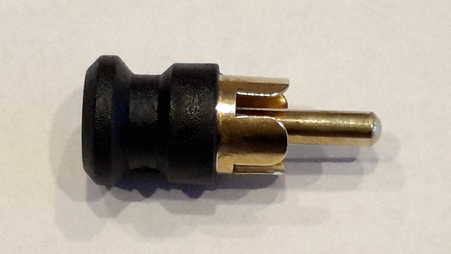

Which main-out are you using - norm or lab? My GTP-500 II didn't work correctly when using lab without using shorting plugs in the norm jacks. Seems strange to me but :dunno:
I've tried both and both are bad. Did you mean shorter cables? I've tried a 3' and a 1' and both work fine with my other adcom preamp.

I meant this:

Wtf I have never seen one of those. Is that a Bestbuy item or am I going online to find that? It's called a shorting plug? I assume I plug into that before going into preamp?
Amazon has them. You plug into the RCA jacks labeled norm when using the lab main out on the pre.
My issue was that one channel barely had any output. When I put the shorting plugs in both channels worked properly. Right now I have a tube amp plugged into the MAIN OUT norm jacks with no shorting plugs installed. I am pretty sure that when an amp was plugged into the MAIN OUT lab jacks I needed the shorting plugs installed in the MAIN OUT norm jacks in order for both channels to work properly.
Per the manual of the GTP 500 the shorting plugs go into the CD input if it is unused. If the CD is used it says not to put them into MAIN OUT or Tape OUT jacks but any other jacks are fine. The manual for the GTP 500 II doesn't mention shorting plugs at all. So be careful.
