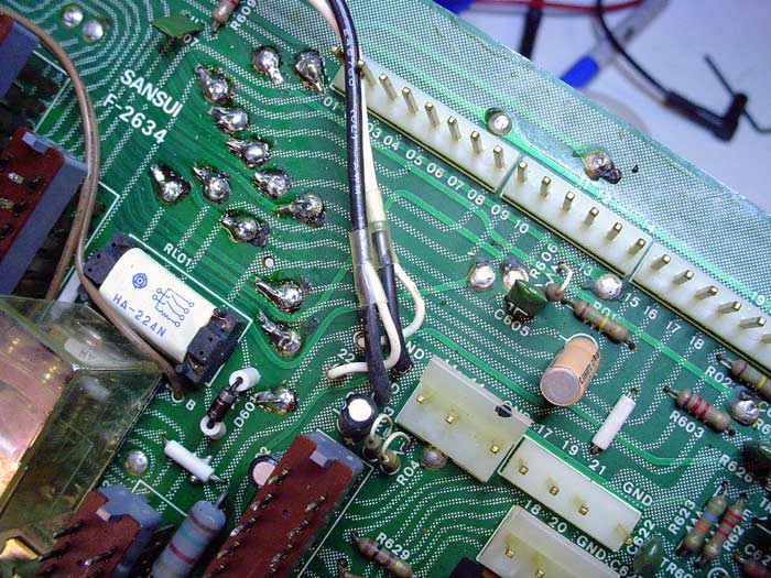

My thoughts were that hooking up a set of RCAs should be pretty easy - locate the wires where the preamp sends signal to the power amp, and pigtail off a set of wires to a new set of RCAs on the ample real estate on the rear of the receiver.
Anyone else done something like this, and if so, the pros, cons, and opinion on the relative ease of the job would be appreciated.
You should be able to add main in/pre out jacks. It would just be a matter of locating the wires and mounting some RCA jacks. Check out the Rean NYS367 jacks on mouser.

To use the EQ, put it on tape 2 of the luxman and use the dubbing 2 to 1 to get EQ into the luxman tape 1 output to the integrated. Again all while looking over the schematic of the R-1050 to find where the preamp signal can be stolen and jacked on the back of the receiver.

Dust off the Sherlock Holmes hat ... If you can track down which board is the preamp section, you should be able to locate shielded line level cables from that going to the amp section. Usually easy enough to spot and test. Something similar to these ...
From there, repurpose a set of RCA's on the back panel that you're not currently using. Add a Y cable to those, and you get the best of both worlds, with both the pre out AND/OR still using the built in amps.

I had an integrated amp that didn't have pre-out Main in jacks so I added them. I ran the shielded cables from the preamp section to added pre-out jacks, and added shielded cable from the I put of the amp section to an added set of main in jacks. I used jumpers on the jacks to connect the preamp and amp sections. If I wanted to use the amp as a preamp, I just pulled the jumpers and connected a power amp to the pre-out jacks.
Just a word of warning about attempting to add preamp outputs to an amp or receiver that didn't have them. Not all preamp sections are capable of driving an outboard power amp, their output impedance might be too high. Which also means that the amp built into it would have a very high input impedance, and not be compatible with an outboard preamp. Which may be part of the reason main in/pre out jacks weren't included in the first place.
Also, some of these units don't have separate amp/preamp sections and some even integrate the tone controls into the NFB loop of the amplifier proper.
I don't know if that is the case with this particular unit. It's just something to be aware of.

Yup. That's why using soitte4 cables if possible is a non invasive way to do it. If it can't properly drive the amp you just remove the cables.
One can always add an opamp buffer with a gain of between one and two, though not everyone will want to do that.
