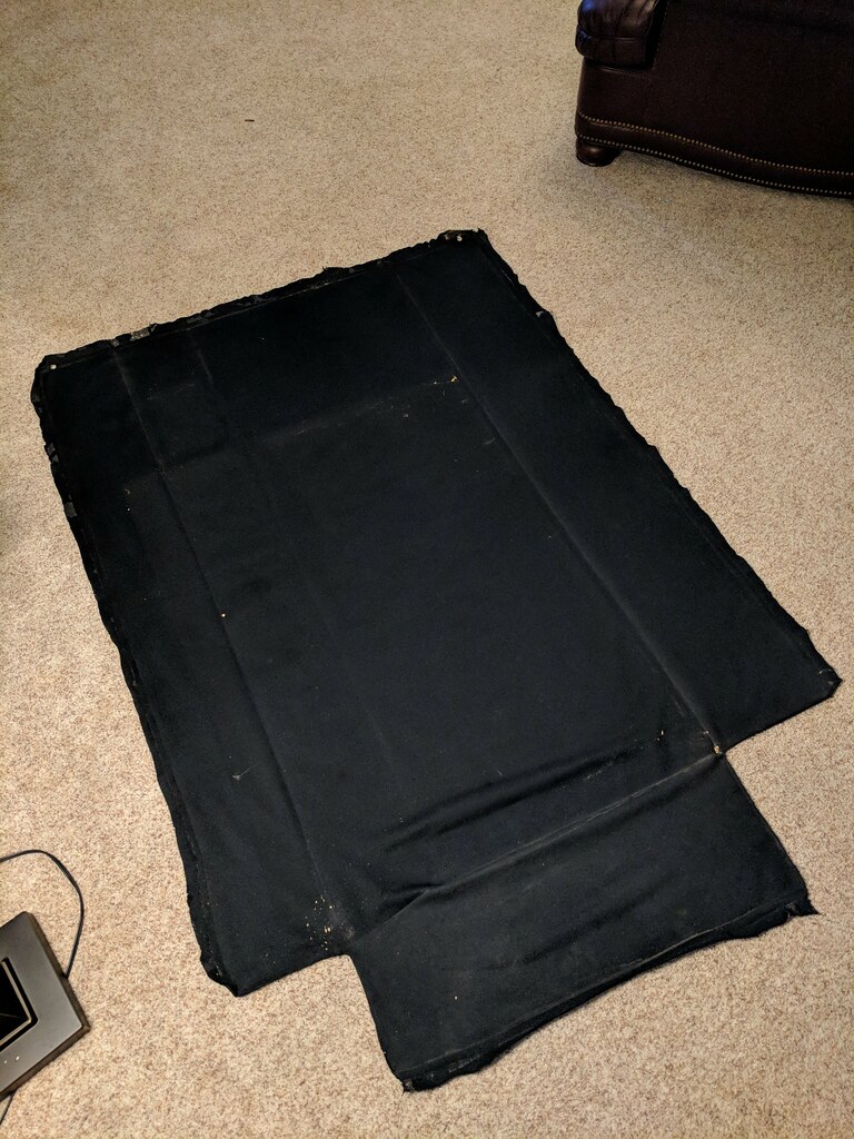

Thank you all for the motivation to get back to work. While switch panels were next on the agenda, I found out my mother-in-law might be able to help with the stitch-work, so I've went ahead and jumped head first into the grills.
I've only worked on one grill frame so far. The fabric came off rather neatly and should be able to be duplicated pretty easily. The grill frame, on the other hand, has been stressed and broken in couple places. Most of the damage appears to be to the top plate rabbet joint. Any ideas on repair? I doubt I could simply get away with some wood glue and finish nails. Remaking the top panel would be a challenge for me considering the limited woodworking tools I have available. What are your thoughts?

Grill fabric, top towards bottom
ADS Grill Fabric by Audio Database, on Flickr
