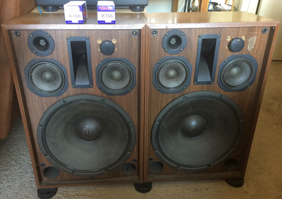

Finally got them hooked up... driving with ChiFi 8 watt EL34 amp. Also just received a new pair of JJ E34L. Testing them out at the same time
All drivers are working (Kabuki) :beatnik:
Not sure what happened to the plates -- I'm almost positive I put them back on when I recapped them
I recapped these for a buddy 8yrs ago

I bought four of these SP-5500X speakers this summer and attempted to get the crossovers checked/recapped by two different electronics shops in my area. One obviously did not want to do the job, as he kept raising his estimate as I agreed to the cost, to the point where his estimate far exceeded the speakers value.
The second shop held ONE speaker for three months (no room for all four), before telling me he found nothing wrong with the drivers or crossover. Then he gave me an estimate to recap all four speakers for twice what I paid for the speakers. I refused.
I bought a MESR-100 V2 ESR Meter from Amazon, pulled/checked all of the crossovers, and found no obvious bad caps. However, I did find two completely dead (open) S-133 5" Midranges and found a pair for sale on eBay. It was strange that the two bad drivers were in one pair of speakers with pink wires from the speaker terminals to the crossover, and both were in the left hole position. The other two speakers have green wires to the crossover. Were open drivers installed at the factory on purpose, or just part of a bad batch?
The speakers sound fine with the original crossovers, but I'm sure they would sound better with a recap, but I'm not spending over $1000 to do that. (I don't have the visual acuity, or the patience, to do the recap myself.)
What I did want to ask the experts is their opinion on the Sansui W-147 Woofer Driver. This driver does not have much throw. Not a lot of "punch". I have a powered sub-woofer to augment the bottom end. Would a driver change benefit these speakers?

For more punch use a more powerful amp. This series of Sansui speaker has incredible power handling. They are sensitive at the expense of low bass, so not a high excursion driver.

I'm curious how you tested the caps with them still in the circuit?
It's a shame those two shops ignored your pleas for an easy repair. Recapping is NOT hard if I can do it. And for cost?? Maybe 100 bucks for decent caps, ones FAR better than stock, even when new.
My man, I'd do it for you if you were in my neighborhood. I've recapped probably 20 speakers, and sometimes it gets a little tight in there, it's usually pretty simple. Could possibly help if you told us, in a general sense, whereabouts you are. Maybe some kind AK'er might assist you.
You'll never know what these babies can really do with 50 year old (and likely cheap electrolytic) caps.
I can't stress this enough. As for the woofer, another AK'er has already explained. That woofer doesn't move much, and it would be damaging if it did, because their excursion isn't up to today's expectations. They're not bad woofers, just made a different way for a different purpose.
I had some 2500's from this lineup, and after really hammering them awhile, those surrounds loosened up a little.
